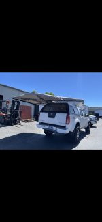

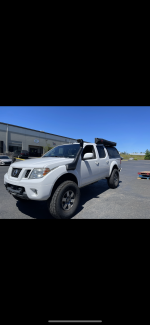

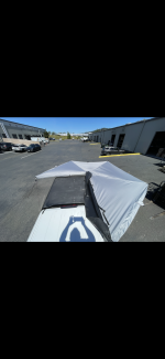

Not much fun to be had lately between moving and work but have been getting out fore day trips . Put my canopy back on and put on a 270 awning , so quick and convenient don’t know why I waited so long to get one . Ordered a set of coilovers from carbon shocks . Not a lot of options out there for Titan swaps so I figured I would give them a try , I like that they called me to discuss my vehicle and driving habits to make sure I got the right spring rate and valving , nice to hear from a human and not a automated machine . IMG_7275.pngIMG_7278.pngIMG_7279.png
