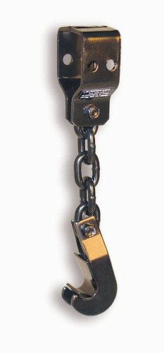

So I'm new owner of a hi lift, any thoughts / tips for lifting from a 2" receiver opening? Is there an adaptor for the hi lift that makes it a more secure jacking point?
It's not a good idea to lift the whole rear of a vehicle with a hilift.. VERY unstable for that use!
Maybe a shackle for use with the hilift as a winch.
Thanks, I have one of those but was thinking they're not that stable of a jack point?
I agree with Verdesardog that lifting from the receiver is not a stable way to do it, but this answers your question for a means for doing such a lift. There are times in life, of course, when such a lift would be desirable. The other way to do it, depending upon how far back under the bumper the receiver is, would be to use the Lift Mate on the receiver's chain hook loops.
Good call with the chain hook loops. I'll give that a shot in the driveway and see how it does.
