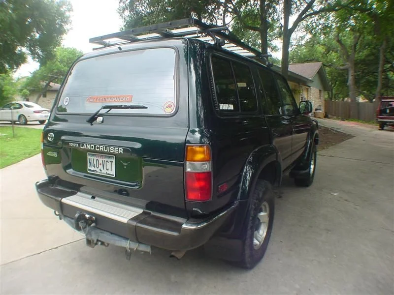

J-Moose Aluminum ramp
I made this one for my old 80-series. I also used the Wildyoats (Johnny Lange) idea of using an aluminum ATV ramp. Very lightweight and mounted to the truck via Thule/Yakima style gutter clamps.

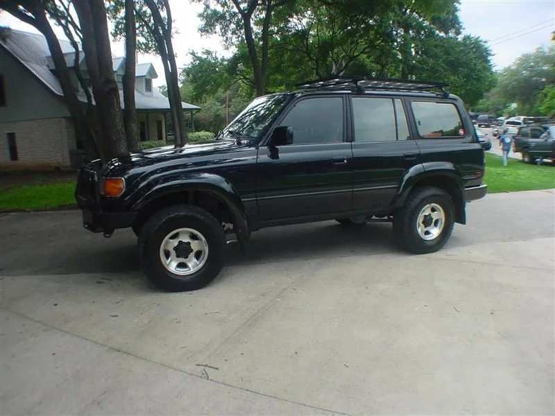

I have had several variations on my roof racks, all homemade. I also have made my own gutter mounts, they are fairly simple to make.
Here it is in its original form on my taco. Bolted directly to the topper with no issues over 2.5 years before I got rid of the truck.
Here, I had to cut out ond side and the rear of the rack to fit my new RTT on top.
Fast forward to my XJ, I cut the original rack, lengthened it, and added a small front basket. I also made my own gutter mounts. I have had 600+ pounds on it with no issues.
View of the gutter mounts.
front basket will hold 7 jerry Cans etc.
