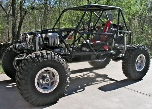

haven
Here's a very capable Tacoma, with a few custom parts!
