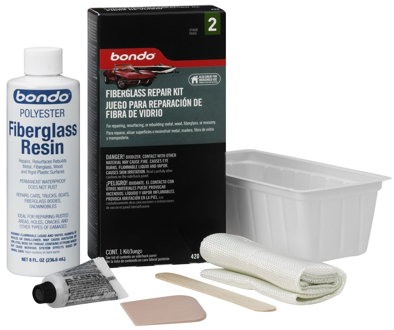

I do not own a Pelican, but I believe they are made from a glass filled nylon material. This should be patchable with a standard fiberglass patch kit.

I love pelican cases. I thought they were ABS plastic, but turns out they're polypropylene. Info in the faq below from pelican. I can confirm what they say about most adhesives not sticking well to it, but it's not as tough as polyethylene. So my 2 cents, if the holes are little and you don't need it pressure tight, I'd fill the holes with a good 2 part epoxy. And if they're bigger, I'd probably glue a thin sheet metal patch, maybe aluminum flashing, on from the inside also with epoxy. If you use sheet metal, rough it up on the glue side with sandpaper before gluing. (The reason I'd use aluminum is that it's thin and light, and epoxy sticks great to it. The weakness would just be on the plastic side.)
