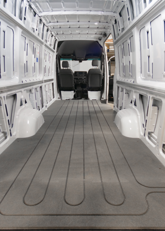

Rixens offers a fairly complete DIY kit and a la carte pieces.
Rixens is partnered with a company that makes systems for routing PEX lines for van floors. They CNC rout a fiber reinforced foam panel for placing heat spreaders and tubing. The kit also includes a matching routed plywood subfloor. I'm not sure if the foam is Coosa, 3M or something else. I'm curious what R value they are getting from these foam boards as that spec isn't published.
