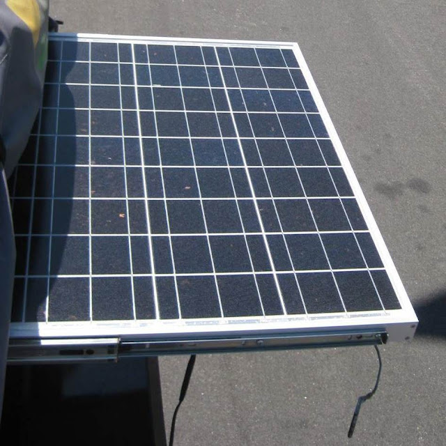

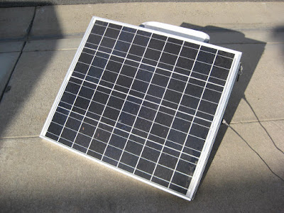

more pictures
Solar Panel
Slide mounts
Mounting point for tent rack
Lid hinge pin
