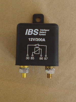

Sierra Expeditions is pleased to announce that we are now carrying IBS - Intelligent Battery Systems.
This computerized dual-battery manager kit was developed in Switzerland. This state-of-the-art system uses a RISC micro-computer to either isolate or link multiple batteries as needed. Normal operation separates the starting battery from the auxiliary battery to safely power electrical accessories when the vehicle isn't running. An override button links the batteries for high-load uses such as winching and is also used for self jump-starting. In-cab monitoring, which uses an LED display to show each battery's state of charge, is available. The system is offered in 12-volt and 24-volt models (controls four batteries). Installation involves an included power cable and a pre-made four-wire harness. The IBS won a Global Media Award as one of the best new products at the 2009 SEMA Show.
Dual Battery Systems (DBS) kits include:
  • 200A Relay (12v Systems)
  • In-cab monitor with flush mount (optional mounts available)
  • Wire Harness
  • 10' of 4g positive and negative cables
  • All connectors needed to complete installation
Features:
  • Low Battery Alarm on both batteries (Beeping and flashing LEDs) - Can be de-activated by pressing display button.
  • Selectable display (bright or dim)
  • Link Failure alarm (beeping and flashing LED)
  • Forcible Link Deactivation in case of aux battery failure.
  • Bi-Directional Automatic Battery Linking
  • Manual Battery Linking - 30 & 120 min
Installation is easy with only 4 small gauge wires that need to be feed through the firewall, no clips or funky connectors. You can see the install of our unit we used for testing here and here.

Alan, from our research the new kits include a different relay with safe working loads of 200Amps and capable of spikes to 500A. In testing, we had no issues with the relay testing under load (winching, jump starting others, Etc..) so this leads me to ask if your relay was the same style as shown above or if it was the older style relay without the uC?

T-max uses the orginal Battery Monitor (prior version) meaning no dimmer, constant display, requires in-line fuses, and has the kludgy solenoid. The IBS kit also has all cables and hardware to complete installation.
