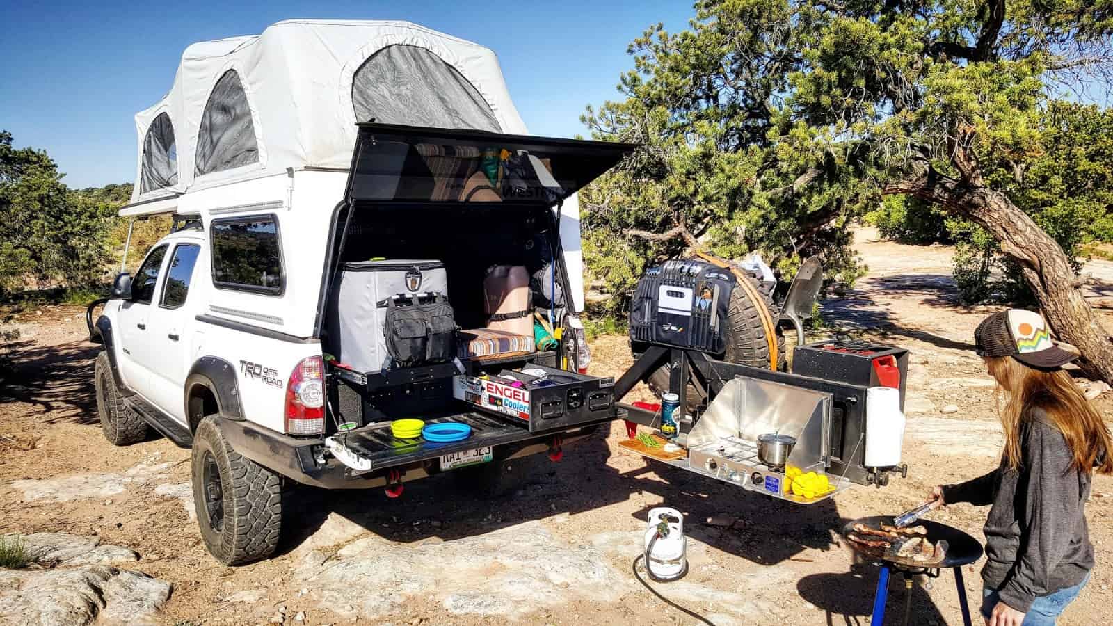

From the "most popular articles of the decade" link above.
"Jon had the truck weighed and realized that his Tacoma was 2000 lbs over the factory rating. This explained the sag he was beginning to feel in the OME Dakars. "
If it's worth doing it's worth over doing!
rruff
I knew he was overweight, but didn't think it was that much. The camper weighs very little; it's all the stuff. And I wonder if he included occupants in that weight?
I had fantasies that I'd stay under GVWR with my Tundra. That's a light but big camper mounted to the frame, and I know how to make light "furniture", but then I started adding things up, and... no way in hell.
