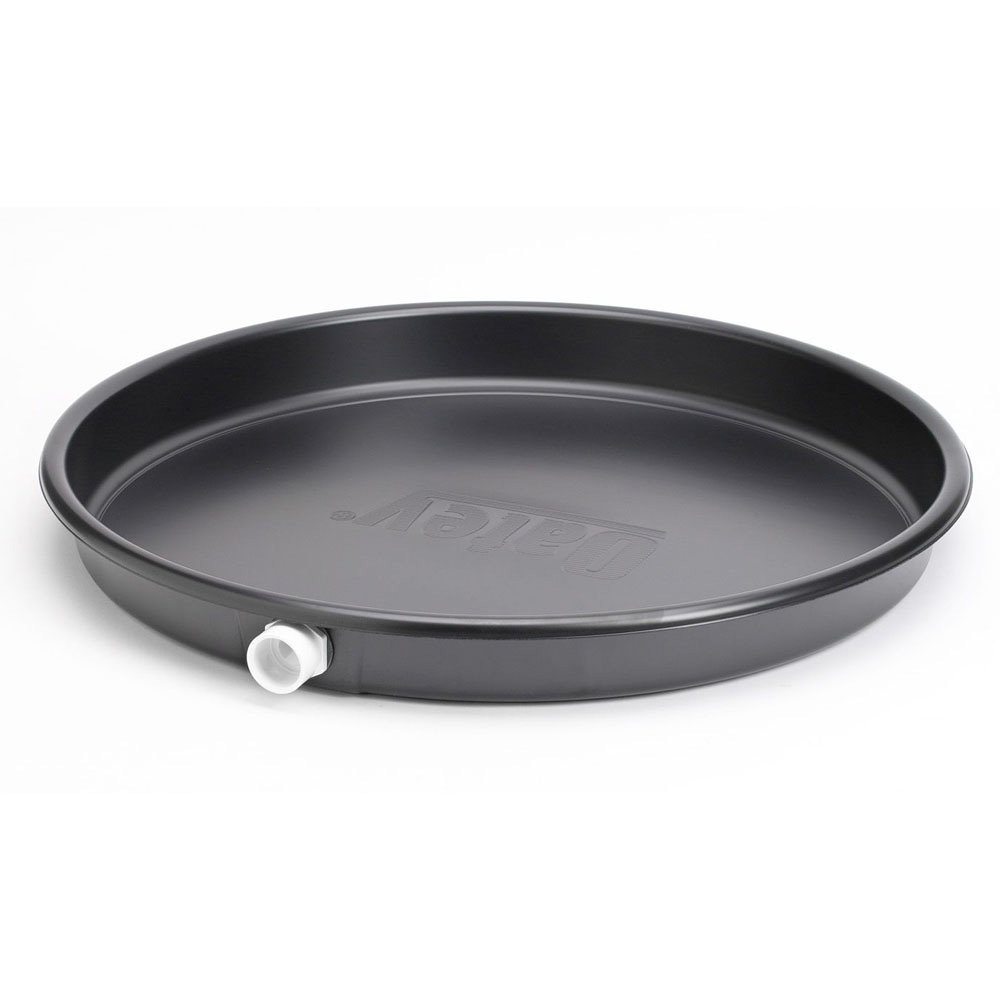

I'm like a lot of others here in that I'd rather do it outside to keep the wet mess out of my living space but I can see the need for stealth and expo events. I would say that if you only do this once in a while I would go with the rubbermaid container and store all the shower accessories in the bin. That way if you don't expect to need it on that trip you can leave it at home. If you do then just toss it in.
What about using the 24" round shallow pan like someone mentioned and then attaching one of those nylon collapsible kids tunnels? Maybe have a couple of hooks on the ceiling to hold it vertical and shower inside that. It would pack down very nicely if the tunnel was the same size as the shower pan ~24". Also it has no overlap seams to let water escape. Put a hose fitting on the pan and run the drain hose out the truck bed access doors and into a catch basin if needed. Then all you'd need is a long kitchen sprayer hose on your sink to shower with.
