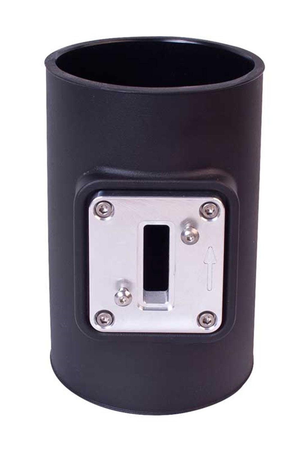

MAF position is indeed important. If you go to the GM performance site and pull up an LS# crate motor and then pull up the instructions you will find dimensions and orientation for it's placement for that motor. It may not be your motor but it is a good starting point.
This is a good MAF mounting solution
https://www.amazon.com/Airaid-9641-Hitachi-Adapter-Plate/dp/B00HJDJGN8
