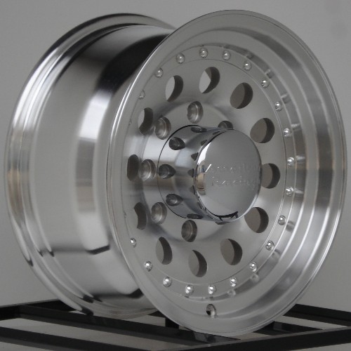

I'm not finding many pre-2011 GM wheels that would work, besides the ones I already have! Sure wish they were 17s. I'm asking myself, 'how bad could it be?' if I just put the widest 33s I could find safely on them. I still need to ballpark my likely future utility box and camper combo for weight estimates- I'm pretty sure any E-load tire will be up to the task, and I'll also be buying for treadwear longevity. There is a decent looking 17x8" American Racing option that could work- thinking these painted satin black.
And here are the H1 wheels I'm considering. I'm still really, really curious what it would technically take, i.e. if recentering would be required, and if they're worth the hassle. Can I not just bolt these on with spacers? What's my factory bolt pattern measurement? I go for unique stuff on my vehicles, so this would help me stand out from an otherwise pedestrian looking truck. It's got the stuff I'm looking for with the build ideas. This guy is 3 hrs. away, kind of borderline worth my time. But I'd love to just slap a set on. And need 33" tire recommendations if possible. Thanks, guys.

EDIT: reply... "Yes I have 5 12 bolt wheels that I will sell by themselves. They are 8x6-1/2" lug pattern. And the back spacing is about 6.5" "
Is this the same pattern as '8-165'? Would the backspacing work better than 3.5"?
