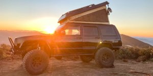

The poptop assembly as I bought it. Being that a VW bus doesn’t have a hood the roof is much longer and comes in two parts;
the tent top and the luggage rack. On this model bus the tent was in the rear and opened with the high side closest to the driver cab.
JGP-jeep-cherokee-xj-westfalia-poptop-camper-conversion-volkswagen-fiberglass-parts.png
^ This is the part that is used to fit the cherokee, it is still too long even without the luggage rack.
JGP-jeep-cherokee-xj-westfalia-poptop-camper-conversion-fiberglass-overhang-fitment.png
Above is the luggage rack. I set this aside and had no use for it (later sold).
The original jeep forum “jeepagon” spliced the edge of the rack to the open end of the poptop.
I decided not too as the splice is a pain and has a upward facing crack to leak. Mine rather glasses a new profile to the open end.
Original Prototype Glue Up. a thicker board was used. Glassed with 2 plus of mat and then trimmed to fit.
The top was redone and no longer uses this method. See further into the build thread for later modification.
The original rear was slightly slanted out and maintained a flat profile.
The canvas from a bus is also too long so I trimmed and re stitched it.
Luckily the mesh on this one was just about the length of the XJ so It was preserved for the most part.
Spring Bar Mounts
Most of the hardware on the VW was old and not installed the best after decades of use.
Luckily all hinges were straight enough to use without binding.
I flipped the top around so that the "back" of the VW bus would be at the front of my XJ.
This worked well and fit the curve above the widnshield once trimmed.
