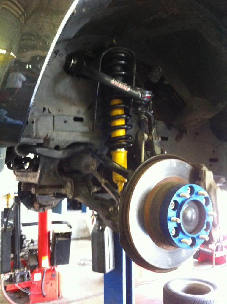

Well, this has been a long time coming. I finally completed my suspension install and got some new shoes this past weekend. I installed the OME suspension with 885/895 springs and their new Nitrocharger Sport shocks. Is it stiffer than stock? Yes. Is it unbearable? Not in my opinion. I had an OME suspension on my old Wrangler TJ and for the money I thought it was the best riding suspension you could get. So far, I feel the same way for the 4Runner. Although, I understand that many of you do much more extreme off-roading and much more often than I do. Anyhow...

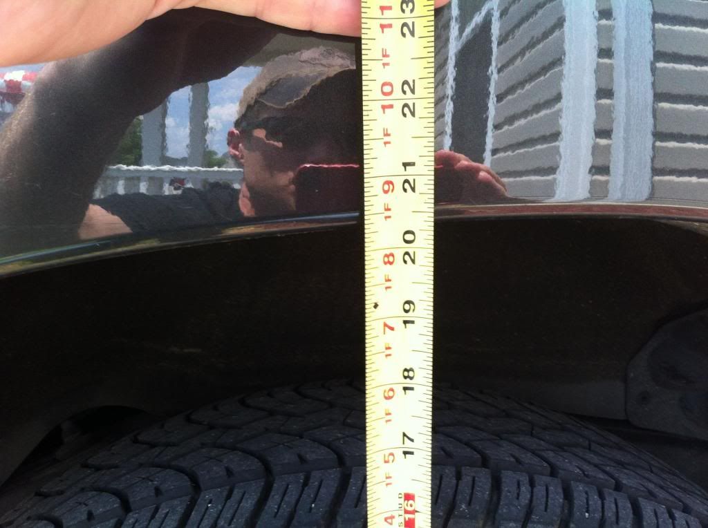

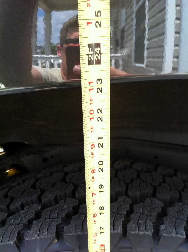

Approximate rear pre-lift clearance measured from hub to fender edge.

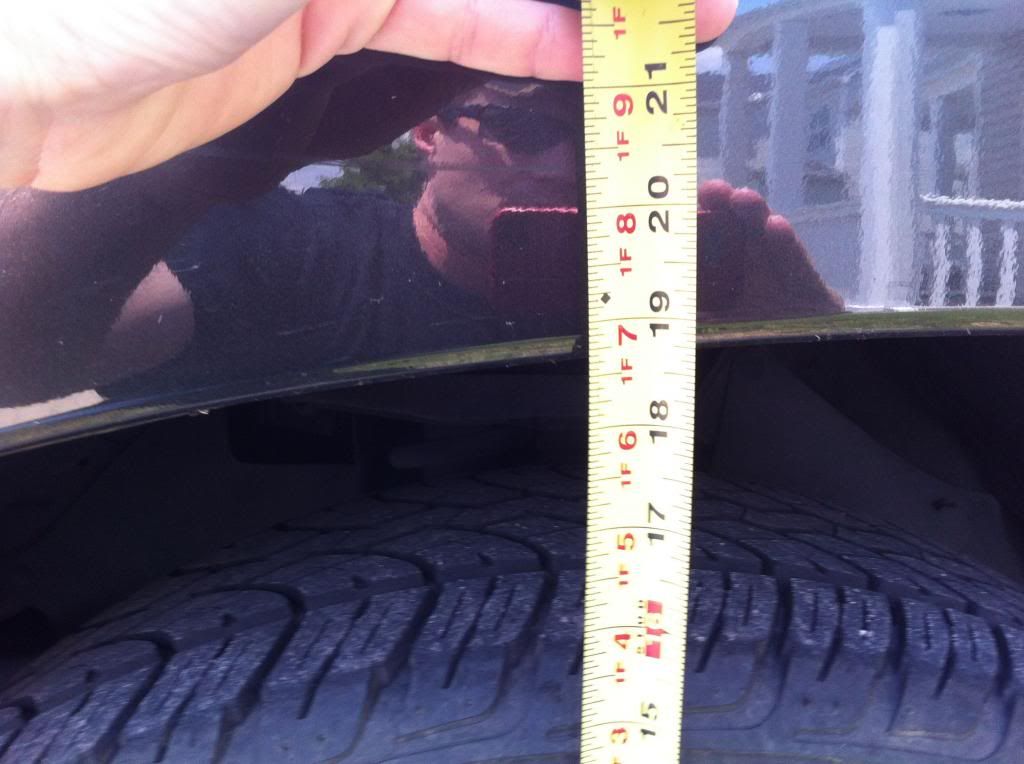

Approximate front pre-lift clearance measured from hub to fender edge.

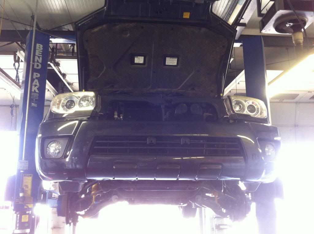

Up on the rack.

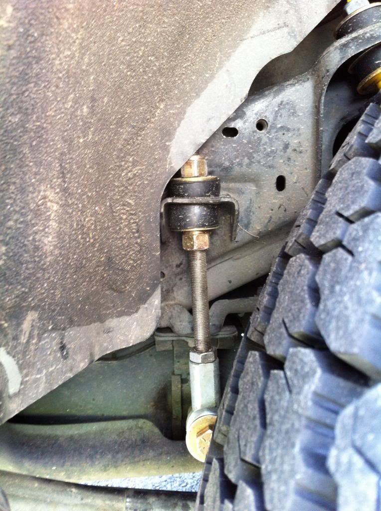

Rear sway-bar end-links from Chris North (Badmotorfinger on Toyota120.com). Beefy stuff and smooth install.

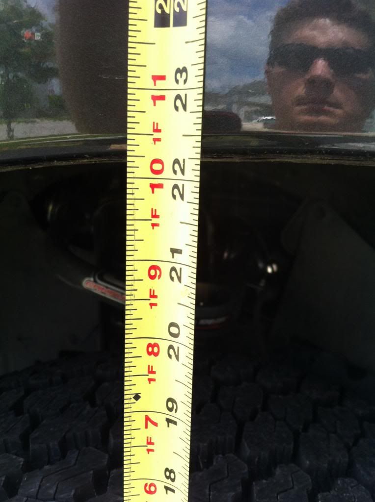

Approximate rear post-lift clearance measured from the hub to the fender edge.
Approximate front post-lift clearance measured from the hub to the fender edge.

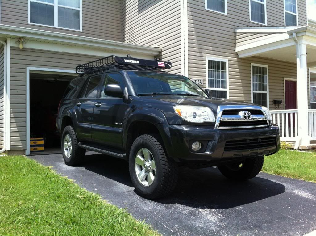

Post-lift side shot. The wife insists that the running boards stay for use as her step until sliders are installed.
Post-lift passenger side quarter shot.
