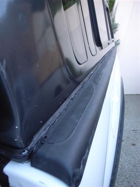

The Tacoma has plastic bed caps that cover the bedsides, but not along the front (behind the cab). So when I initially put the camper on, there was a 1/2" gap along the entire front of the camper. The solution was to remove the bed caps, which after doing so looks like this:

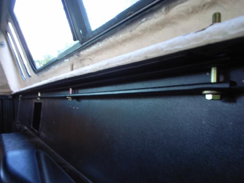

The camper was then aligned. I drew lines on each side of the bed rails to aid positioning. To attach to the bed, I discovered the holes in the stock rail system lines up adequately with the sides of the camper. This was a relief because my initial plan was to fabricate brackets; it is not necessary. To mark the holes for drilling, I put some paint on the end of a bolt and put it through the rail system from the bottom so that it marked the underside of the fiberglass camper side. After the paint dried the camper was removed and the holes drilled from the bottom. There are 5 attachment points on each side (the camper was mounted previously by 3).
The setup is secure but there are a lot of entry points for water. The next step is to seal the sides. Silicone Caulking was used. The holes on the bedsides are visible but drain between the fender and the bed and don't enter the camper. It is a bit unsightly though:
The plastic bedcaps were cut and enough clips left in so that it still attaches to the bed. Another layer of silicone was added to bridge the gap to the camper. The result is a camper that looks recessed into the plastic bedcaps but is flush with the bed.

Curiously, why did you remove the bed rail caps? Why not bolt the top down on top of the rail caps?
I am sure there a million ways you could have done this, and you did what works for you, so no criticism here, just curious if it wouldnt have fitted with the rail caps intact?
justinhw
The rail caps don't extend to the front of the bed, so there would be a small gap that would have to be sealed. Honestly I could have left it and put a few layers of weatherstripping there, but it seemed easier for me to just take the bed rails off so it sits flush all the way around.
