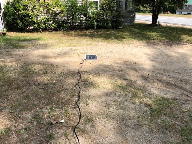

Tested the panel out of the box, 22v DC. Clipped on a couple of leads to a big resistor I have kicking around and got 8.3a in full sun 90 degrees to the panel. Wired it up with a 20’ run of 10ga fine strand copper wire soldered to the diodes, wrapped in that expandable nylon wire sheathing, terminated with a SAE connector. Tested in the shade about 7:30PM and still got over 18v over the 20’ run of cable.
