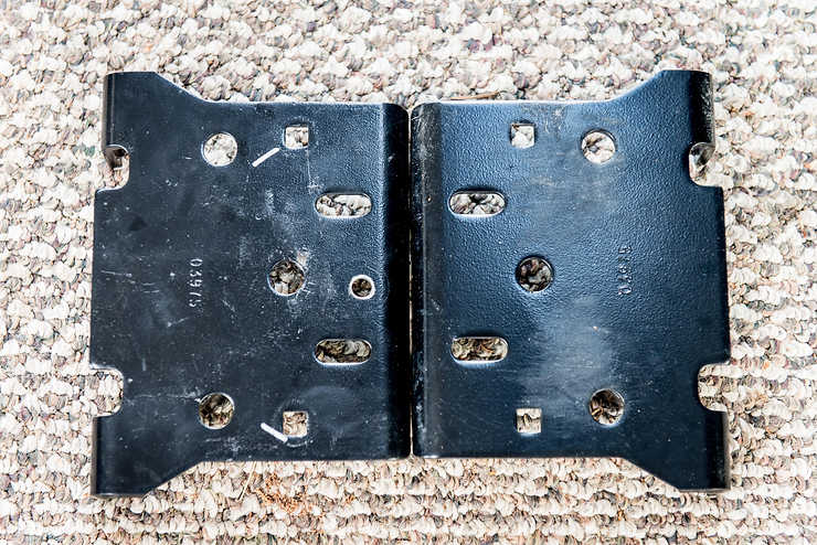

The Air Lift kit is well designed and comes with all required hardware to install and plumb the bags. Before I get any further into the installation, I'll note that I installed the kit alongside a set of Daystar airbag cradles. These are a contentious inclusion and are mentioned by the manufacturer specifically as a modification that will void the warranty. So why add them? Simple, with stock the Air Lift kit, the bag is constrained between the upper mount at the frame and the lower mount at the axle. When the axle is fully drooped out, the bag is helping to carry the weight of the axle as well as potentially restricting the amount of travel. By eliminating the hard mount at the lower axle and instead replacing it with a cradle, we get all of the load carrying capability of the bags, but the two uncouple when the axle droops. Neat right? Anyway, a few modifications to the kit are required to fit the cradles, but I'll get into that later.
The Air Lift instructions do a very good job detailing the installation procedure, and the kit will install with basic hand tools. First step is to remove the stock bump stops from the frame and bolt on the Air Lift bracket.
With those out of the way, we can begin doing mockup with the kit. Since I knew I was installing the Daystar cradles, I deviated from the instructions a little bit. On the lower axle mount plate, there is currently no hole to secure the cradle, I needed to add that. After fitting the bag to the upper mount, and affixing the lower mount to the axle, I was able to place the cradle on top of the lower mount and adjust its position to it was centered on the bag at ride height. Note, the cradle will not be centered on the mount, it is offset inboard. With the cradle in place I did two things, first was mark the center hole for for the cradle mount bolt, and two, make a few marks along the perimeter of the cradle so I would know it's position. With this done, I drilled the mounting hole, primed it, and painted it to prevent future corrosion. Side-by-side shot of the cradles so you can see where I chose to drill the hole (modified on the left, stock on the right).
Now, this is where marking the perimeter locations of the cradle come in handy. It mounts to the axle via to carriage bolts , but you'll notice that the cradle rests on the heads of the bolts. This requires making some relief cuts in the cradle, but it also has some radial support ribs on the underside. Rotate the cradle until the bolt heads line up with the unsupported perimeter sections of the cradle and mark for the relief cuts. I used a 1” belt sander and files to hog out and shape the material. Once you are done it should look something like this.

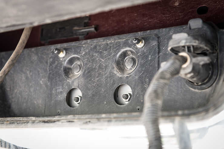

Routing the air lines is personal preference, but I chose to replace the license plate bolts with the air stems. I plumbed the bags separately, and for good reason. If they are plumbed to the same air line using a T-fitting, they will transfer air bag and forth to your detriment. Think of it like this, while cornering, the bag on the outside wheel will be loaded up due to the sway of the vehicle while the inside bag will be unloaded. If connected, air from the outside bag will simply take the path of least resistance and flow to the inside bag, softening the suspension and increasing body roll. If plumbed independently, this cross-over flow doesn't occur and stability will be maintained.
That said, I chose to route both lines down the driver's side frame rail along the existing wiring harness. The passenger side bag line could be routed along the passenger side frame rail, but there were no convenient places to secure it. I instead routed it down onto the axle, ensuring enough extra line to account for axle droop, before running it across to the bag. After staring at it a while, it was, all in all, the cleanest way I found to route the lines.
Instead of drilling additional holes for the valves, I instead ran them up to the license plate and replaced the license plate bolts with the valve stems. This required drilling out the hole in the plastic backer a little bit, but it was a minor inconvenience achieve, what was, in my eyes, the neatest way to do it.
