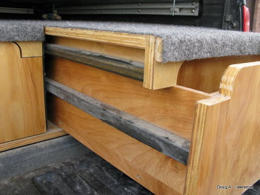

Excellent design and craftsmanship. I too would like to see photos of your drawer top slide design. Using bearings was a great idea.

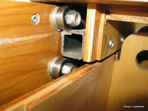

Could you show a pic of the slider that holds the fridge with the fridge on it? How and where are the supports to hold that amount of weight? Pictures would be awesome.
The fridge/bed slides were designed and built exactly the same as the drawer slides. There are a series of roller bearings which support a length of 1' square tubing which is attached to the side of the slides. You can see the bearings and a side shot of the drawer in the pictures posted previously. I can post additional pictures shortly.

Side Shot
Clearly shows the square tubing attached to the sides of the drawer and top slide.
Bearing/Steel Tube Detail
Shows how the square tubing rolls between the roller bearings.

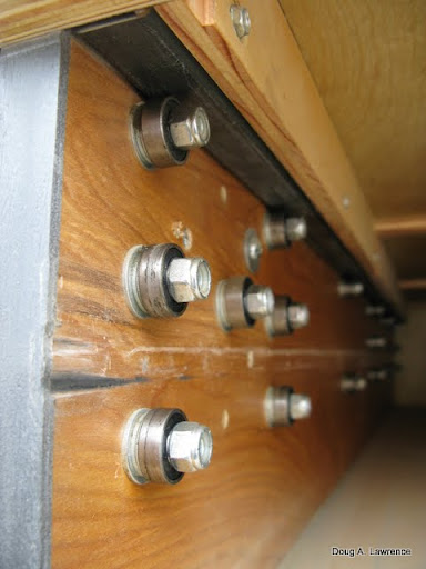

Bearing Detail
Here's the best shot I can get of the bearings themselves. Not the square tubing at the top - this is one of the slides for the top slide.

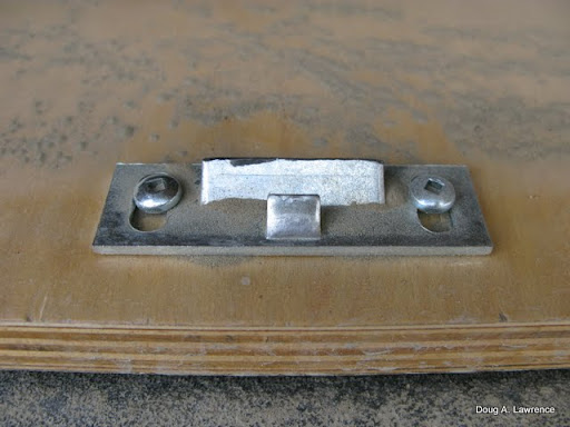

Drawer Catch
Attached to the bottom of the drawer openings. Spring-loaded latch catches here and holds the drawer shut firmly.

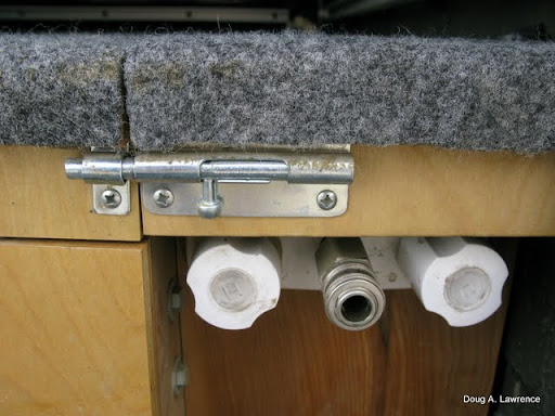

Top-Slide Catch
Simple barrel bolts were used to secure the top slides from sliding open every time we open the tailgate. I am going to try to integrate these into a way of being able to hold the slides open at varying lengths. Right now it all or none. You can also clearly see the quick-connect faucet that was used.

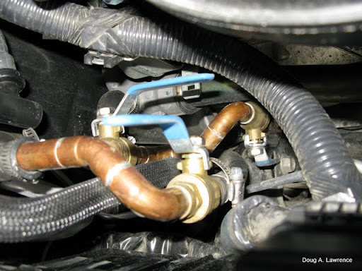

Engine Coolant Tie-In/Bypass
One of the most important factors when I was designing the hot water and canopy-heater systems was integrating a way of separating this loop from the factory heater loop in case we ever experience a leak. The following picture shows the copper manifold/valve assembly that I created to tie these new systems into the heater hose. Works great - and so far we haven't had to use the bypass!
