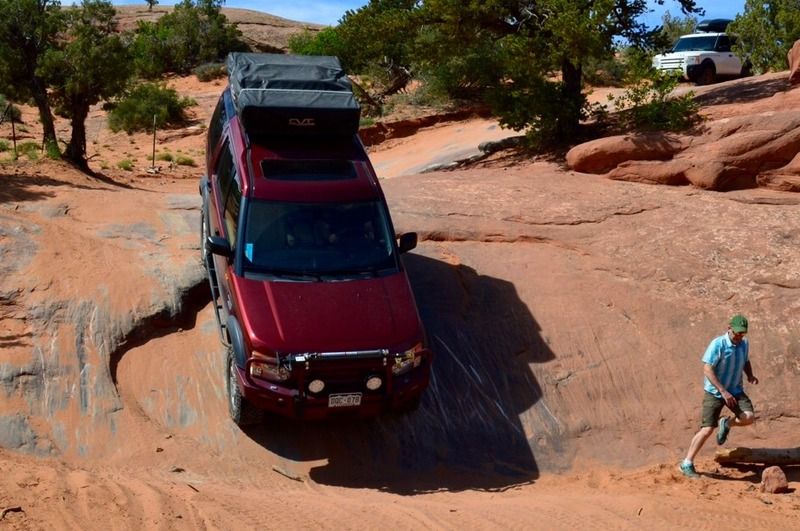

I understand and agree to an extent about the lack of down travel when running an LR3's air suspension 'lifted'. It does have an effect. And there is definately a different technique wheeling one of these things compared to a traditional solid axle rig like a D1/2, RRC, or Defender. Most of the guys I wheel with are in mod'ed Discos or RRCs and in some instances I actually have it easier than them but in others I'm at a serous disadvantage. The biggest drawbacks of the LR3 platform in my opinion are lack of break-over and/or rocker clearance. Because we can't do a lot of lift or run large tires (32" is common, 33" less so, and 1 or 2 guys are running 35" but only with significant cutting and not on dual-purpose trucks) we just don't have that clearance. Again, this means taking different lines but sometimes there's only one option....which means you'd better have good armor because you'll be riding steel. The other big drawback is the sheer weight of these things. Loaded my rig comes in around 7500 lbs. (!) and I'm not unique in that.
I haven't wheeled with a 100-series (have been out with some 80s) but I suspect it has more in common with the LR3 than not. They are pretty similar in a lot of ways. Don't tell the guys over on the cruiser side, but I actually sorta like the looks of the Lexus variant even if I wouldn't want to buy one. They all think I'm the antichrist because I made a positive comment about Rovers on their side. And by default if I said something good about one it must be something bad about the other...
zelatore
BTW, I have 'ideas' about increasing down-travel but haven't implemented as I'm a bit worried about over-extending the CVs at full droop if I do. Need to get back into that now that I think about it.

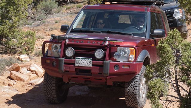

I checked out Jeeps, Toyota and just about every other potential vehicle for a Overland rig. The only Jeep I liked for the task was a wrangler. Drawbacks were ride (long term road travel), internal space (hauling gear), ability to sleep inside the vehicle if need be (hard shelter in the event a tent cannot be used) and of course expense. Jeeps cost too much for initial investment plus modifying it to suit my needs. Incredibly capable off-road but ultimately not designed well for on road travel to reach long distance destinations.
Toyota is built like a Toyota. Japanese are great at fuel economy but generally at the cost of build strength and comfort. When you get into their SUV market the fuel economy is only slightly better. Again initial investment is still high and expense to modify took it out of the running.
My LR3 had it all. Initial investment, $8200. Cost to modify, minimal as it came with the ARB bumper, Voyager sliders, Johnson rods which provided lift but lift can be attained by simply reprogramming the EAS. Air suspension plus really comfortable seats for long OTR trips to reach destinations. Ability to fold the seats flat and sleep inside the truck if need be. Very capable off-road with terrain response.
