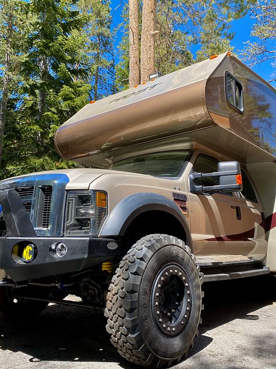

DIY style lift for the Ford F550 Chassis/Cab. Mine is a 2009. Looking to achieve a 3" suspension lift.
I have found a number of sources for front lift and steering components, but the rear is less clear. BIG parts?
Would love to hear others that have achieved the "poor mans Earthroamer" suspension lift, and happy to share my progress.
here's my lil beastie
and..... the project
