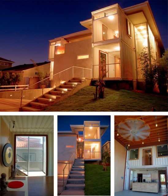

Who has seen Tron: Legacy? The character Sam Flynn lives in a few shipping containers almost the same as in this pic.
