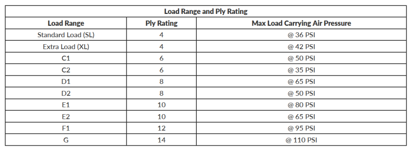

Load range is pressure and equivalent ply ratings. Between tires of the the same range but different sizes the load capacity will vary. The tire and wheel association defines what layers of reinforcement are needed for the equivalent ply rating (fabric equivalent plies). This is mostly sidewalls, but also affects tread belt reinforcement.
Load index is specific, and will tell you exactly that tires capacity is. Two tires of the same size and load range can have significantly different load index (and thus maximum carrying capacity). This can be very important when using oversize or non stock tires, and you are running near a tires max load. Choosing the same size and load range in that case may result in an overloaded tire. The OEM size and load range takes that into account, and they select typically for the lowest weight capacity for a given load range/size.

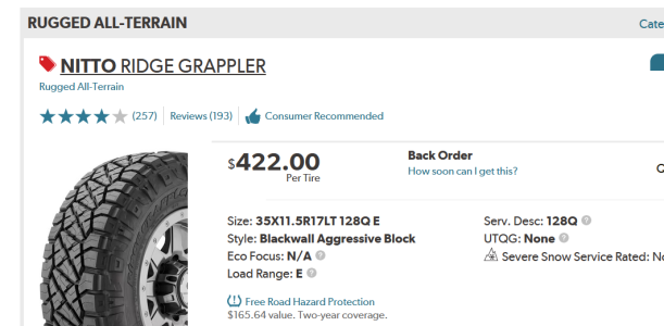

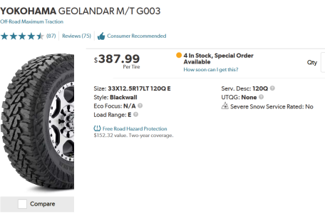

For example on the confusion with load range. In the 35" tire, a range E is 128 load index. While a smaller tire in the same range E is 120 index. A difference of nearly 900lbs per tire.

As shown above, load rang (letters) need to be coupled with a specific tire size to be meaningful. Load index is more absolute.
i.e. A "C" rated 40" tire will have higher capacity than an "E" rated 32" tire. A load index 131 tire will ALWAYS carry more than a load index 121 tire, regardless of size.
To make things even more confusing, many 17" tires are artificially capped at 3195 lbs, even if it's a giant 37" E rated. Unless it's a "legacy" tire grandfathered in - Nitto Mud, Toyo Mud, etc. They have 4300 lbs payload in 37" E

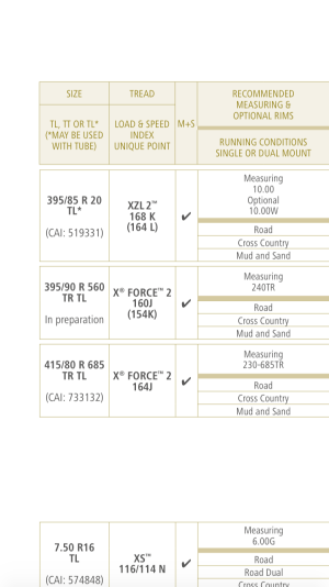

Michelin at least on some big military tires does a”singular point” thing:
Higher load capacity at slower speed, or lower load capacity at higher speed. Here’s an example:
The 395/85 R20 XZL2
I run Michelin 305/70R19.5 XDE2 on our 4WD motorhome. It is intended as a semi trailer drive tyre.
They provide a wide range of load and speed data for this tyre. It is rated at 3075kg per tyre at 112psi for highway speeds but they also quote overload speed limited information.
It has a single steel sidewall ply (and 5 steel tread plies) which makes it brilliant for running in the desert at low pressures.
