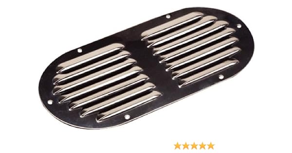

Side vents cutouts in process..
(these further complicate the idea of a sealed cover)
Once the epoxy is cured, the final cut will be made, to connect outside to inside the box.
The holes are 3-1/2" in diameter, and sized to fit ABS pipe that will act as a sleeve.
The sleeves will be epoxied in, edges rounded over, than glassed like the box.
Vent cover will be one of these stainless louvered guys
