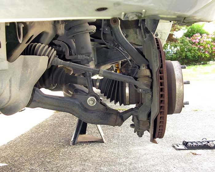

Hate to say it Musky but a quick tour round Safeway's carpark revealed this:
Toyota 4 Runner late model - sheetmetal control arm.
Toyota 4 runner 90's at a guess - sheetmetal control arm.
Toyota Tacoma - sheetmetal control arm.
RR sport - sheetmetal control arm same as LR3
Nissan Xterra - sheetmetal control arm.
Lexus LX470 - Sheetmetal control arm.
I din't even start pokinga round the cars.
Are you seeing the trend here or am I not aware of how other vehicles are made? I guess all these companies are just wrong with their IFS design and the crashes are just masking the failure rate.
The only 4X4 there that had cast control arms was a Jeep Grand Cherokee but I didn't see a Honda Pilot to check.
Land Rovers can be reliable but they have the quality ratings they do for a reason and it is not preventative maintenance. As you are on dweb I'm sure you can quote more of the issues like leaking sunroofs, galvanic corrosion, the P38 etc. than I can.
Wow, Land Rover can be proud that they are following the lead of others and are now lumped in with a bunch of mediocre vehicles.

from the base Tacoma to the top of the line Land Cruiser, Toyota IFS lca's are fully boxed. Compare a 4Runner to the LR3. Go look at them in person, the LR3's is weaksauce.

So the argument is that the IRS may have failed first. Then the IFS collapsed. That is supposed to be better?
There is a LR3 here at work and the suspension looks so weak. spindly tre's, weak control arms, tiny cv's, paper thin mounting points and the airbag is pretty small too. on top of that the hardware is tiny.
This is minimal requirement engineering. There is nothing rugged about it.
Too bad, it's nice looking and I like the interior. Good to learn the RRS has the same underpinnings- I can warn my friends.
The only real LR's are solid axle ones. Hopefully Tata realizes this and brings the level of quality up the current crop.

However, the point of the thread is not about the LR3's prowess (or lack of) off the road, but whether there is a design flaw or major QC problem with the control arm. I think it's a useful idea to publish details of incidents like this on the various forums, so we can get an idea of common defects. But I think the slightly hysterical reaction to what appears, so far, to be a rare occurence, is actually counter-productive. At this stage, if I drove a Discovery 3, I'd take a look at the state of it underneath, but I wouldn't lose any sleep over it. My attitude would change if this started to be a common occurence.
