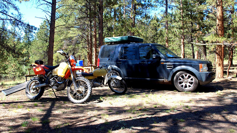

This weekend in New Mexico:
drcoopster, did you have some cement bricks in the truck there? The suspension looks totally bottomed out!
I used my IIDTool to completely deflate the air springs so that the RTT ladder wasn't vertical. It also reduced the swaying of the tent when I was moving around or the wind was gusting.
In case you're being serious...he has the air suspension lowered to access height (bump stops).
Access height isn't quite that low on this truck; I have it lifted about 1" via IIDTool to avoid the slight rubbing with these wheels and tires at stock height (RRS wheels with 255/60-R19 tires).

??? "IIDTool" ? I want! Why would your tires rub? 255/60x19 is not huge, basically the same or less than my bfg 265/65x18 right? 31.5" tall.
About the RTT swaying, on factory drop, mine seems quite stable and my ladder reaches the ground with plenty of angle. Maybe your ladder is shorter or rack higher. (I see your ladder is in fact about a foot or more shorter. Neat looking tent.

Frequent use for my LR3 lately: KTM base camp.

What's the weight of the bike and mount on the rear of your LR3? Do you have many miles with that configuration? In actuality I'm curious regarding tongue weight and whether it's noticable at all with the air suspension. I suspect not.
