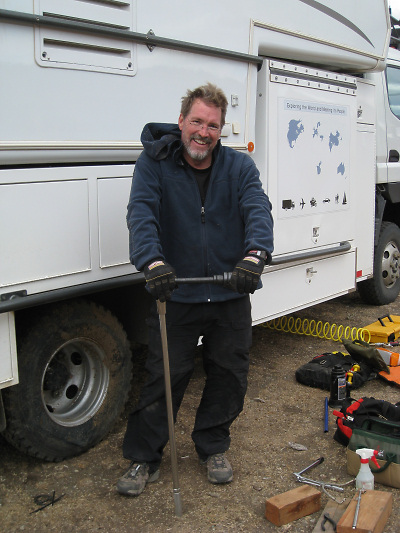

Not more than a week after I posted about this we had our first flat so I got to test all this stuff out here in the field.
I miss-spoke in my post, we were able to get the lug nuts loose using the SnapOn ratchet during testing. I was thinking about the impact wrench, which didn't work at first until I raised the air pressure in the system to 140 psi. Sorry for the mix up.
I used the massively expensive, equally massive SnapOn ratchet for the heavy work. I was able to break the nuts loose with one foot.
I didn't use the impact for everything because I'm only running 120psi in the air system right now due to high altitude issues with the compressor. The impact wrench was handy for everything but breaking and final tightening.
The best part was having Steph watch and having her say "We never could have done it without that ratchet." since she about had kittens when I bought it and she saw the price.
Note that I'm carrying both the two way budd socket and a straight 41mm impact socket. I used the straight 41mm socket for this job, (outer rear wheel, passenger side). You will need a drive extension to reach into the rear wheels.
We are also carrying a full set of nuts for each side (left and right thread) and a full set of rear studs for each side (left and right thread).
