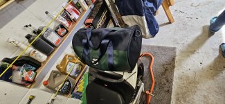

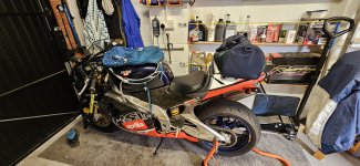

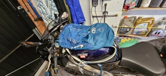

Well maybe I was indeed over thinking it. A small duffle on the back and a rucksack on the tank.
Obviously these would require some straps and maybe some anti slip matting underneath.
I do have some old rucksacks I wouldn't mind cutting up for the tank, so that could be an option.
I'll update as I have more of a think.20230826_133307.jpg20230826_133313.jpg20230826_133316.jpg
Looks like a good start.
Check out Advrider for lots of solutions.
Don't forget the Action Packer...

Fantastic thank you very much!
