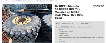

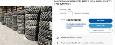

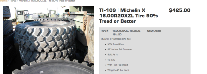

Too bad you were not in the US for tire availability £313 to £610

wow these are cheap
I can get them from europe but for a used in date tyre they were still £1850 each plus shipping from germany to the uk which is now plus vat and import duty being we are not in the EU anymore...
So it was best option for me to buy new.
The 16r20 is really hard to find over here, Lots of 14r20s.
You folk in the US have BIG trucks so 16r20 is much more common i assume
