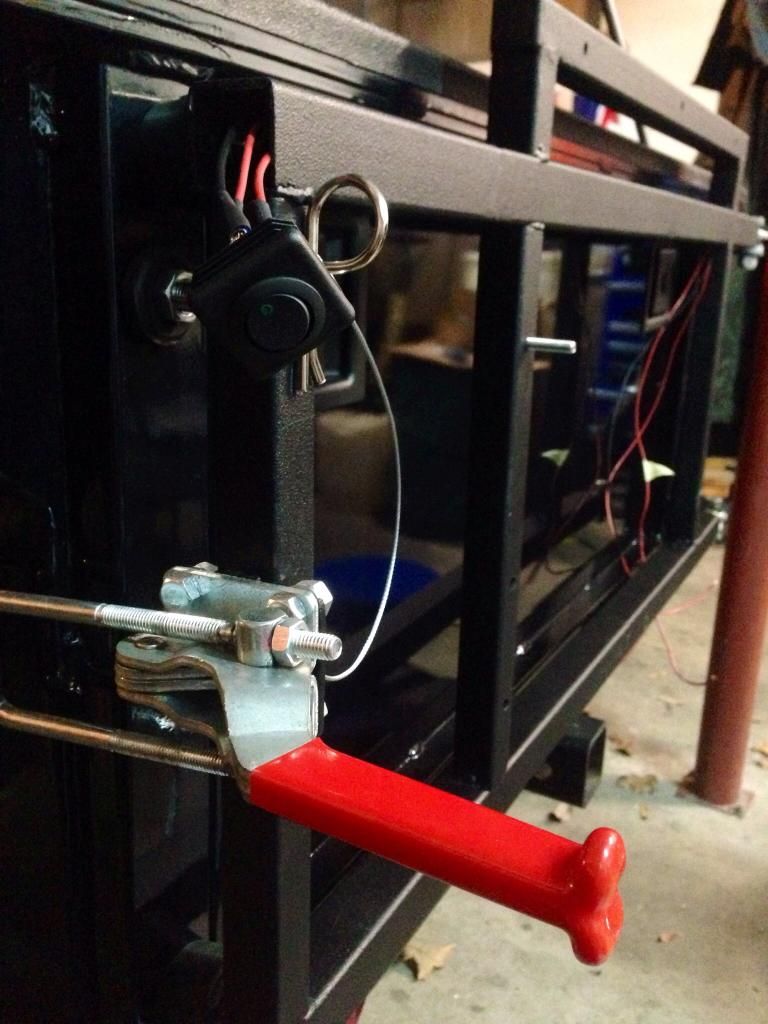

Working on the Pelican Case swing out design and I'm scratching my head on a latch setup.:confused:
I should have done this BEFORE it went to paint, but not knowing how long the paint would take, and scheduling it around work I'm left in this situation.
How could I go about securing this swing out in the closed position WITHOUT grinding off the paint and welding on the trailer!?
Something that preferably would bolt on. :ylsmoke:

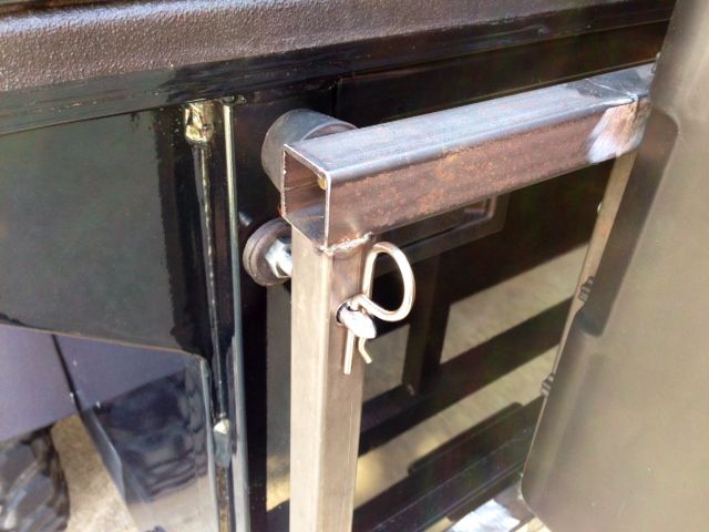

Most of the Destaco latches are all bolt on. I'd use one of those.
Thanks for chiming in Box Rocket. Ive read your thread, nice build.
Ive used them before. I think I'm going to add a vertical piece of square tubing like you did to attach the swing out in the closed position.
What are these called and where did you get them?
Sorry for the late reply. Those tabs are one I found at my local metal supplier (Wasatch Steel). They are the female side of what they call a "batwing hinge". The male side looks identical but has a metal post about 1" long. The female side is just a hole. I have never used the full hinge but I use those female sides for all kinds of stuff.

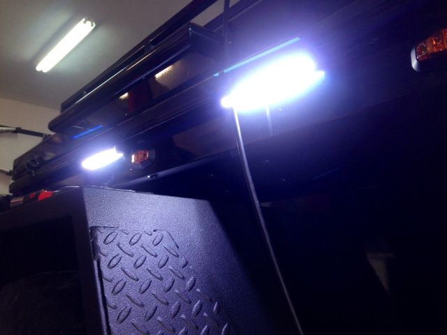

I havent seen anyone on here do this mod yet, so thought I would make an Expo contribution!

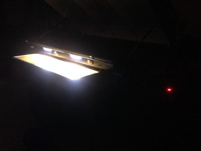

I ordered these cheapo daytime running LED running lights off eBay. Really thin and $9.98 with free shipping from China.
http://www.ebay.com/itm/281219976110?ssPageName=STRK:MEWNX:IT&_trksid=p3984.m1439.l2649
Couldnt pass it up for the price, and wow I am amazed the amount of light they throw out!

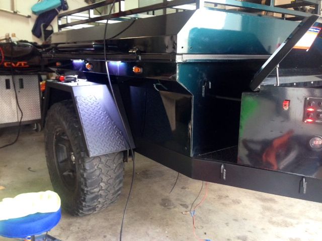

I mounted them under the lip where the trailer lid rests to use as light for the table I built for the fender. The provided 3M backing tape seems to be pretty stout.
I changed the cheap thin gauge wire for something a little more heavy duty. Wired them together and ran them to an open switch I had on the tongue box

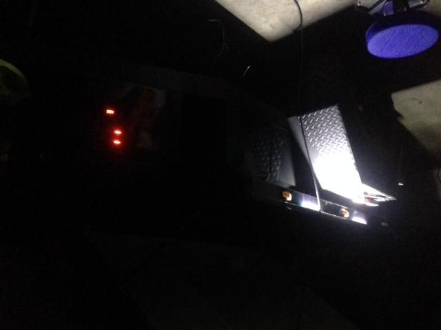

Here are the results:

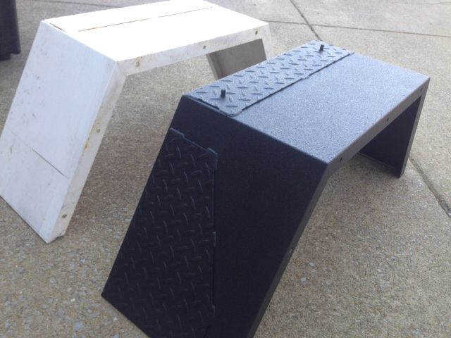

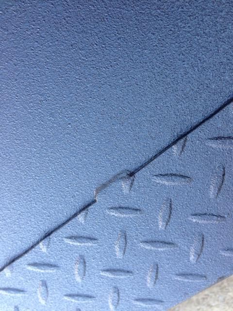

I also rattle canned my fenders using Duplicolor spray bed liner from Autozone. The texture it lays down is very forgiving (meaning an amateur like me can do it with good results!), and it makes touch ups a breeze too

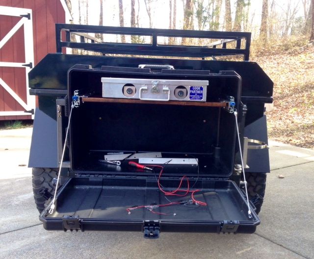

More progress on the Pelican case kitchen. Few more mods left to do but its starting to come together finally
More progress for those that are interested ...

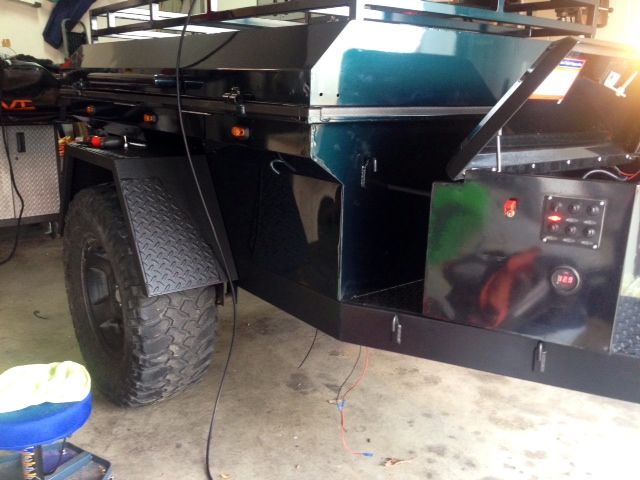

Painted up the swing arm and ran the electrical wires through the frame for the license plate and interior lights:
That rocker switch is for an LED light inside the box

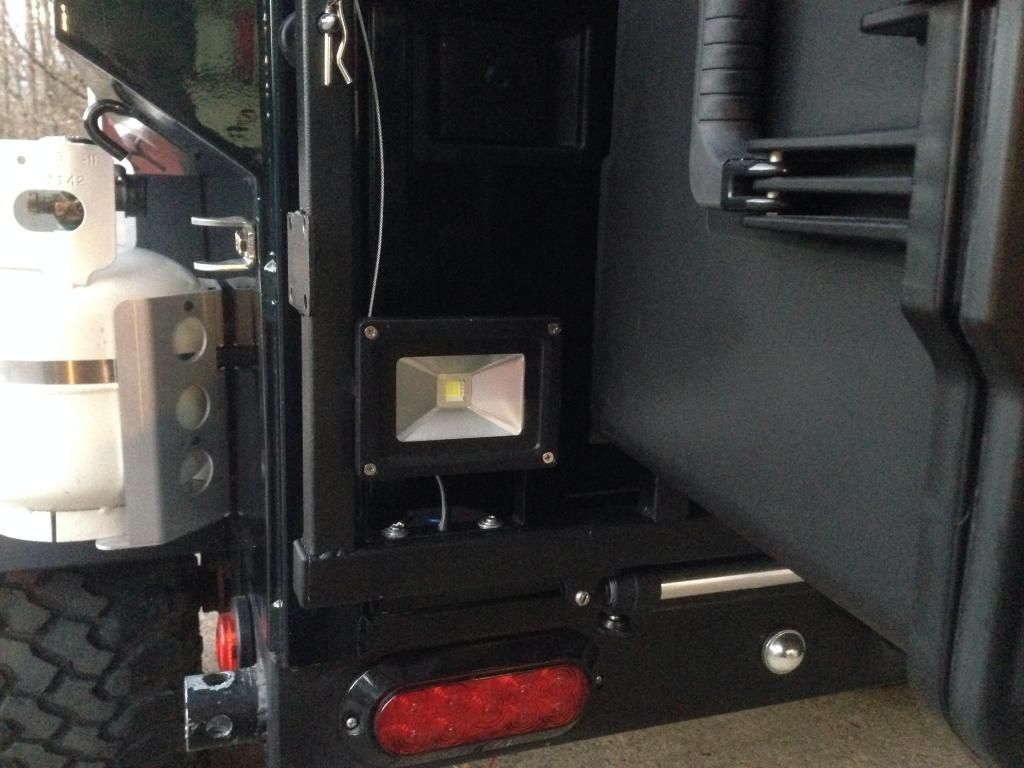

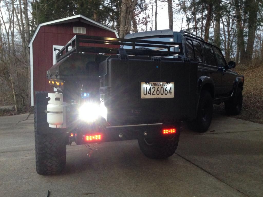

I had a 12v LED spot light laying around that I wired into the reverse lights to help with backing up at night
