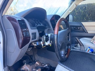

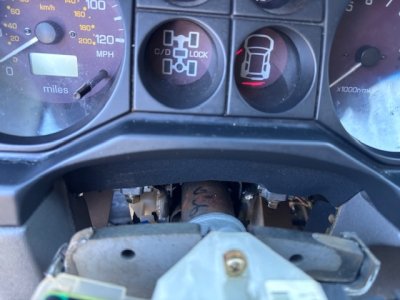

No voltage getting sent to starter could be a few things. Easiest for me to check was the ignition switch. First, I pulled off the covers under the steering wheel and around the steering column. This can be accomplished with a normal Philips screw driver. I think the steering column had 3 screws and the cover below the column where the hood and gas latches are was 4 screws.

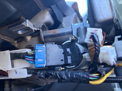

With those covers removed, I can see the ignition tumbler where the key goes in and on the back of that, the ignition switch. However, I still don't have access to the screws on the switch to remove it. To remove the switch, I removed the two bolts holding the steering column up. This allows the steering column to drop down low enough where the screws to the switch are accessible.

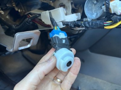

Pull these two screws out and unplug the switch.

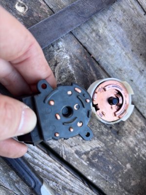

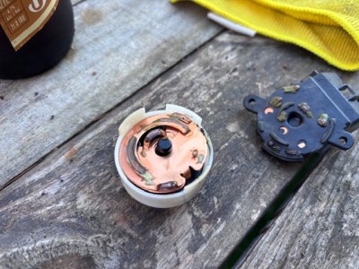

On the bench, remove the plastic cover from the switch. On mine, the contact points are burnt and corroded just enough to not make contact.
I cleaned the old grease off and filed the contacts where they were burnt to reveal fresh metal.
