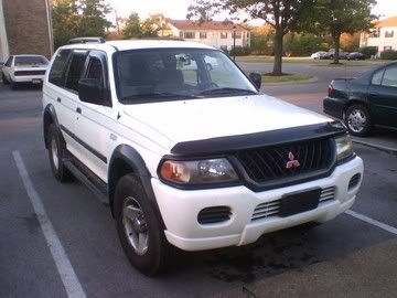

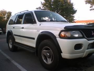

Its always nice to know im not the only one, and as for the color I may be one of the few with a Montero Sport but I do fit in with the vehicle color
As far as lifts (this might get carried a little off topic) we all know the MS is Body on frame what would it take to do a Proper body lift. I have seen it done to some MS on Montersportonline.com but the purchased theirs as a kit and is now discontinued Again hope this dosent jump too far off topic
