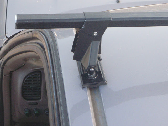

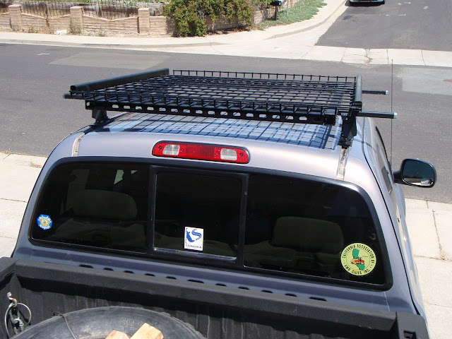

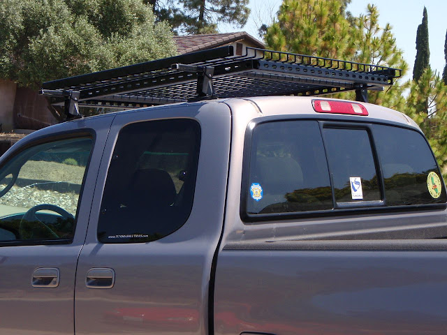

I have a sort of custom set-up on my tundra. I used the exisitng tracks on the roof to bolt the thule "feet". I noticed this groove is the thickest part of the roof on the tundra. It's where the pressed body parts overlap and are spot welded. From there, I used Thule bars and made my own frame for the rack and used a heavy duty pallet shelf for the basket. I flipped the shelf upside down and cut off the excess. Cost for everything was under $150. I had the thule parts from a previous vehicle.
