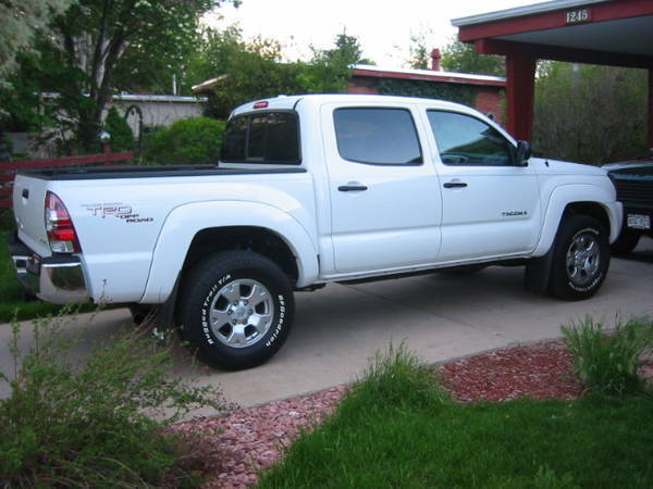

Hello everyone, I'm a long time lurker on the site, and have finally joined. I've read a bunch of great stories and build threads on here but never had a build or any adventures worth contributing. In the past, I've owned an FJ60, Jeep XJ (my least favorite) and most recently, a Range Rover Classic. Now with my new Tacoma, I finally have something I feel will be reliable, comfortable, and capable enough to build for meager expedition travel.
My goals for this truck aren't to build a rock crawler that will be able to tackle any "trail" Colorado has to offer. I commute 70 miles a day and want something that will still be comfortable for all of those highway miles while still capable of tackling any trails I care to pass in order to view some of the amazing back country scenery Colorado has to offer or take me, my wife, and our dog wherever we'd like to go. I will also be using the truck to haul my dirtbike and take the family camping. Of course I hope to be able to take some extended trips outside of the local area as well, and those will consist of both tarmac and off road excursions. My plans call for slightly increased ground clearance, traction improvements via better tires, and necessary armor to keep the body in good condition. I also plan to equip the truck with any necessary recovery and safety equipment.
So far the truck is stock, but that shouldn't last too long. Here's a picture of it as it sits today; I just took delivery 8 days ago. I opted for the TRD Off Road package as well as the auto tranny. I wanted a manual, but couldn't find one with the OR package in my area.
I have purchased a set of 17x7.5" FJ Cruiser steel takeoffs and plan to install a set of BFG MTs in 255-75-17 soon. I believe my stock Rugged Trail tires measure 30.5" while the MTs measure 32" (according to Tire Rack.) This should give me an extra 3/4" of ground clearance.
The next mod will be a topper to protect the gear I'll be carrying and to give the dog a comfy place to ride. I've been looking at the ARE CX series, SnugTop Cab-Hi, and Leer 100XR. Do any of you have any direct experience with any of these brands versus the others? The ARE is the least expensive of the three by a comfortable margin, but I'm not opposed to paying more if I'll have a better experience with one of the others in the long run.
Although I have a couple of things planned for the immediate future, this build will be rather slow. I still have to sell the Range Rover before I can dive in to this project too heavily.
I'm always open to suggestions and recommendations; you are the experts here and I believe there's always room for improvement.

While the stock 09 OR is extremely capable stock I still recommend stiffer suspension. The factory suspension just don't seem to support the weight of the vehicle in a way the really instills confidence on the trail. I don't want to come off an obstacle and bouce. I want tires to remain planted and vehicle weight to react predictably. The TSB 4 leaf pack and aftermarket coilovers work very well and will be plenty for supporting the weight through the first round of mods.
Get to know your traction control systems. They're all useful in the right conditions. Do your homework on ATRAC and go out for a test run to learn how it works. It's a great tool and Toyota definitely had their heads on straight when they designed it. I wish I had it when I went to CO last year.

Thanks for the advice. Can many of the aftermarket coilovers be dialed in to a stock (or + 1") height? I don't really want to alter the geometry at this point, and I'd like to avoid significantly changing the COG.
As an alternative, how about a slightly stiffer spring on the stock front shocks, or would that result in a situation where I'm significantly underdamped?
Personally, I have Icon coilovers up front and with about 1 inch of preload they were sitting just over stock ride height. Once I added the bumper, winch, and skid plates I had to crank them up a bit. Eventually I'll go to synthetic line to cut some weight out of the front but there's more tube work coming so I'll probably end up with an extended coilover rebuild and 700lbs springs any ways. It's a never ending cycle and this board doesn't help:drool:
A very welcome addition to bumper & winch mounted Tacomas! Syn line too takes off about 35lbs of weight off the front too.
