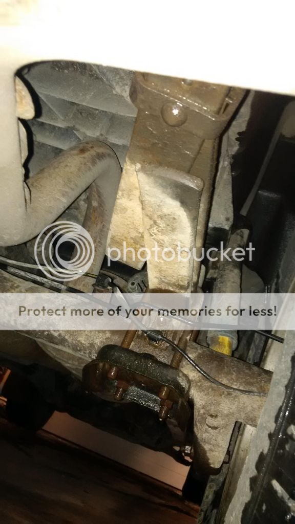

Well, today I heard a funny noise coming from the rear of my truck today, somewhat metal hitting metal clunking when going over bumps. Take a look, and sure enough I have broken a leaf and it has twisted sideways.
So these will be going on tomorrow
I'll probably do the fronts on Saturday.

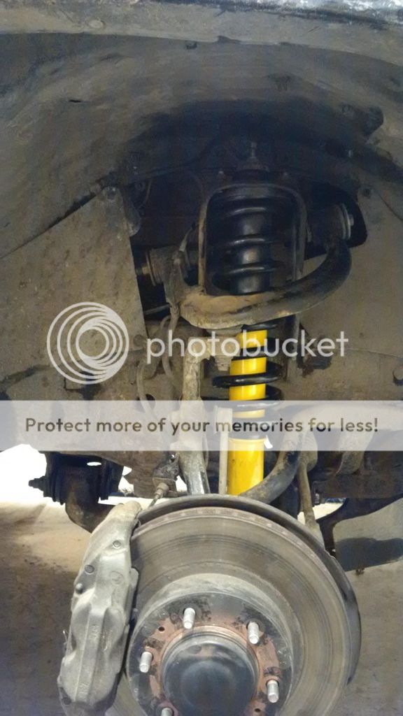

Old Man Emu kit is in! The quality as everyone knows is phenomenal. I enjoyed seeing the differences between OEM and OME.
OEM Rear Passanger
OME Rear Driver
Ride height with OME rears in only
OME Front
I will have to take a picture of new overall ride height today at some point. Overall super happy with this product. Unfortunately due to the panic of swapping the rear leafs during the work week, I failed to do a before measurement of clearance.
