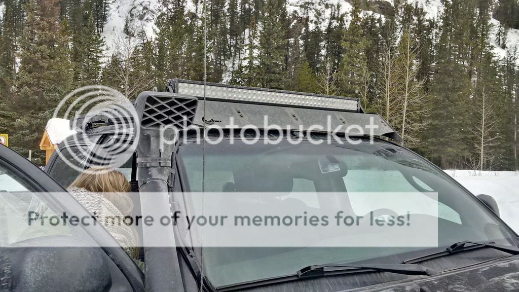

We went for a shake down day at Yoho NP today, but didn't get nearly in as far as I thought we could do to road/trail closures. But overall went great. Only problem I had was my firestik almost decided there was a fire sale on itself. I've never seen a cb whip side to side on the highway like that. I thought for sure it was going to tear the mount out of my bed, or snap itself. Mind you we did have aggressive winds today. I ended up yanking it before it could damage itself or the truck.

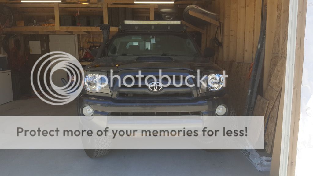

But here are some pictures with the light bars installed
Full shot tall
Full shot wide

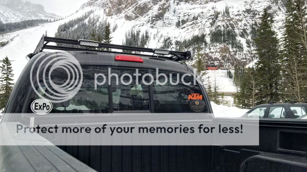

Front Bar and Side 30W above pass rear door
Rear double 30W bed lights
In that last shot you can see my antenna spring in the left hand side of the bed. Has anyone else had issues with this location, specifically issues with the antenna itself attempting to be a gymnast?

Back when I still ran a CB I also used firestik but on a hood channel mount, on a spring the damn thing would oscillate like crazy in certain conditions, like semi wake. Ended up going to a simple quick release, no spring, was much happier with it even though it had to come off when the branches came out.

I had a spring mount 5ft fibreglass on the back of my last toyota- I ended up getting rid of the spring because it let it smash into the canopy too much. Now I have a 5ft off the lightbar up front. It doesn't move too much at all, usually just presses back from the wind.

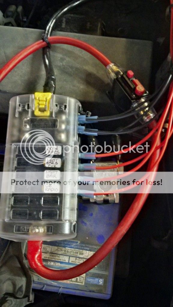

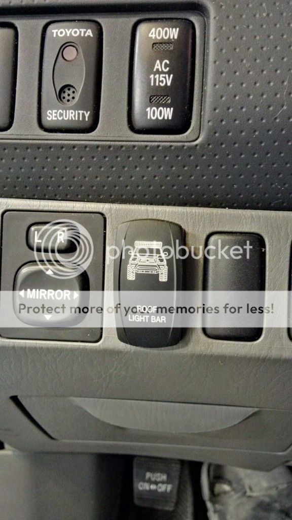

Here are the pictures of the lighting switching, and other accessories. Excuse my dirty interior...
12 CCT Blue Sea Systems Fuse Block with Neg Bus (Temp install, currently fabing a custom bracket)
30W LED Switching
Roof Light Bar Switch (Love this switch, although it's the wrong gen)

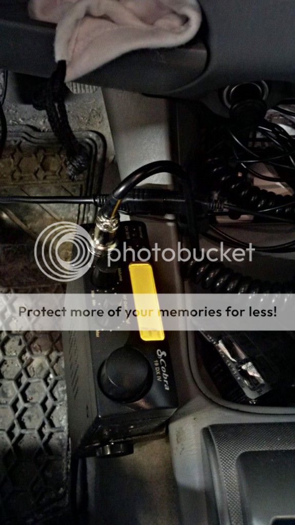

Cobra

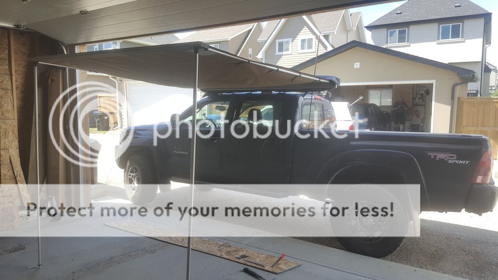

I finally received my 2000x2500 ARB Awning this week so I mounted it to the PrInSu Cabrac today. I'm excited to have an awning now. Don't know if I'll get the awning room or mosquito net but at least the availability is there.
Sent from my SM-G920W8 using Tapatalk

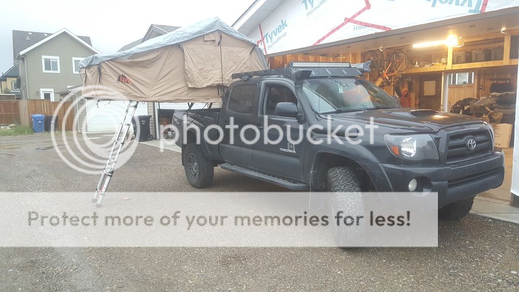

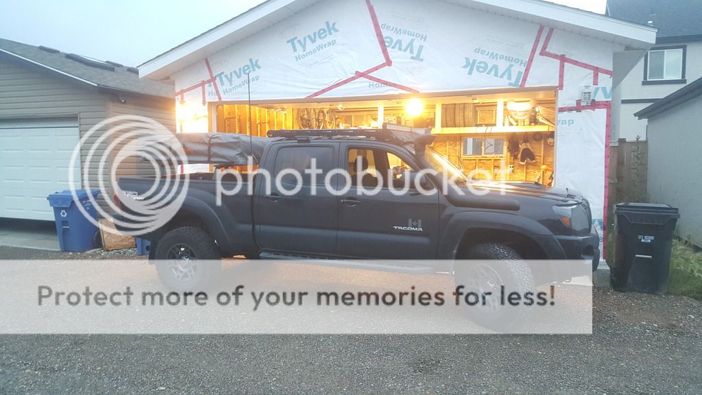

Wow! What a quick turn around from North Shore Offroad getting my tent to me. Including the day I paid, 3 working days later I had my tent. Brought it home and couldn't resist installing it. Luckily my next door neighbor always has a bunch of scrap steel laying around and a drill press, as I had to make my own custom brackets for the mounts as my FR bed bars are too wide for the factory Tepui brackets.
I was originally looking to find an older standard Autana that wasn't the, IMO, awful Siberian camo, but NSOR didn't have any left in stock. I like the tan so they offered me a deal on the SKY model, so I jumped on it.

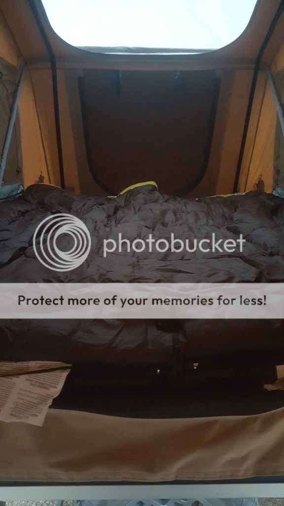

I have yet to install the annex to see if the height on the tent will massively affect the installed height of the annex and whether or not that will affect the ease of opening the doors. But my queen size coleman sleeping bag fits perfectly. I'm stoked to get out and use it and the awning sometime in the next two weekends. Speaking to this, I was watching some videos from Drifta Trailers. He's designed a RTT lift rack with electric actuators and I love this idea. Might look a little funny, but this way the tent can sit under the roof height during travel helping with aerodynamics and after you've opened the tent from a reachable height to get at the windows and such, you hit the switch and the entire assembly raises above you're head. But I will MAYBE do this next year.
For your viewing pleasure.
First opening
A view of the queen size sleeping bag, and a slight view of the sky lights
All closed up
