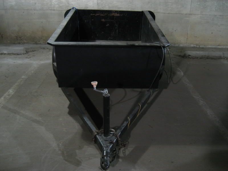

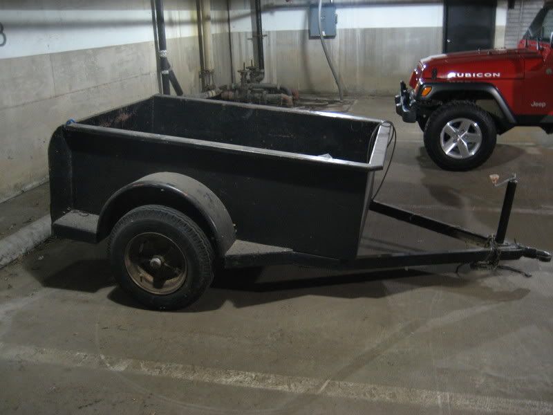

Hello All!
Well, I've decided to convert a small trailer I own into an expedition type camping trailer with a roof rack tent on top. I'd like to paint the body of the trailer red like my Rubicon and paint the top and fenders black. I got the idea from Drew's build on IH8MUD.com:
http://forum.ih8mud.com/trailer-tec...edition-style-trailer-build-up-thread-28.html
I think I'll be able to accomplish this relatively cheap ( I guess cheap compared to what Drew spent) since I already have the trailer:
I drew up these sketches of what I'm thinking about doing (I don't know how to post PDF's so I just took pics of my sketches!). Anyway, I know the angles are way off and it's not to scale and I suck at drawing but I think you get the idea.
I want to put the same tires and wheels as my 2003 Rubicon so I can rotate all six tires (off the trailer and onto the rig and vice-versa). I need to replace the leaf spring (singular, only one spring per side of the trailer?), and figure out a way to lift it the same height as my jeep. I'll probably do a SOA conversion and hopefully that will give me the height i need. The jeep is stock with the addition of 2" RE coil spring spacers. I plan on replacing the stock shocks with RE gas shocks and a 1" BL. In addition I'm going to run Goodyear Wrangler MT/R 285's on the Rubi and the trailer.
I'll need to fabricate a lid for the top of the trailer and a box to go on the front. I want to redo the tongue so I'll be able to interchange a pintle and traditional hitch. I'm sure there are plenty of other things I'll want to fabricate for this thing later on.

Update: I just pulled the trailer for the first time with my TJ and I think it needs to loose some serious weight. I'm going lose the fenders and side "steps" and see where that gets me. this trailer might not look like it but i bet it weighs about 700 lbs.
That is about where I would expect it to be. Time for that super charger you've always wanted! :D
In all seriousness, I built my trailer to help my life slow down a little and get out into the woods again... so the 10mph the trailer takes off my fj40's already slow speed isn't a big deal.
Put your hazzards on and get out there! :D
