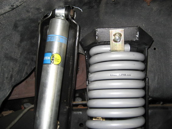

I would call James Duff and buy a set of there extended radius arms which are the same as the Cage units. There are a few reasons to keep the radius arms and coils.
First, it's pretty much a bolt in job. You will need to cut the spring perches off the D60 and weld on the axle wedges.
Second, It allows you great flexibility in positioning the axle further forward to clear you really wide axle/wheel/tire combo. In order to get decent ride out of leaf springs they need to be relatively long, but you only have so much frame on the front side of the axle to mount the springs. Next thing you know you have to build a big f'n cross member to hang off the front of the frame to mount the leafs to.
Third, ability to try different spring rates is a LOT easier and cheaper with coil springs. I have 300 lb/in deaver coils in my 78 now but if I want to go to a heavier coil I switch to a BDS @ 350 lbs/in. It takes about ten minutes per side to swap out. Now imagine you want to adjust the spring rate of your leaf packs.
Fourth, it is a bronco not a blazer:coffeedrink:
Fifth and final, Coil springs are far more efficient and aren't flawed by friction that hinders the responsiveness of the leaf spring. Therefore, in sharp washboard a leaf spring bronco will really be BUCKING but a coil spring bronco will be big PIMPIN.

Thanks for your posts, and I may have mentioned that I am going leaf springs prior but I am no longer going that route. I am using the coil springs that are on the truck and using the spring holders from Ballistic Fab. I will then measure the distance between the brackets and the frame mnount an make my own radius arms for way less then the cage productas. I already got quotes on them and although great, expensive.

This is why I avoid progressive rate coils. The soft portion of the spring rate collapses easily and gets coil bound...pretty much useless IMO

Great lookin Bronco! I saw that you were talking about radius arms on your D60. Cut up your stock set and make some, much cheaper than Cage or Duff. Here are the ones on my D44
