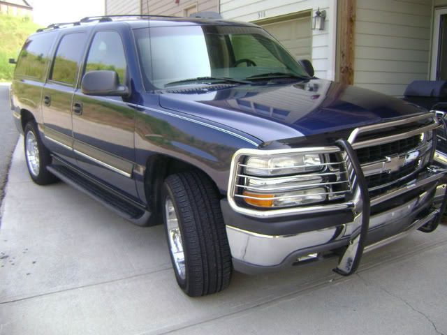

I've been lurking in this section for some time now. With the plans next year including a 3rd child and possibly a dog, I knew the 'ol Liberty CRD wasn't going to meet our family's requirements. I loved that little Jeep, it brought both of my sons home from the hospital.
All that being said, here's what I ended up with. A 2002 Suburban K1500 LS w/95k miles. I wasn't really looking for one this new, but I couldn't pass it up for the price. I never knew this body style came with a coil spring rear suspension. It's fairly base with leather being the only real option. It has 3.73's and no rear locker, no skids, but like I said the price made it too hard to pass on.
As you can see, I've got some work to do. I've already removed the "chrome" door trim and the rear tail light covers. Next, on the to-do list is to find a home for the 20's.
I've searched many times on here for anything similar. Only one thread on a 05 Yukon XL. Anyone have any experience with these Suburbans?
Plans for the future include: 285's (most likely the new BFG Rugged Trails) on 16" wheels. Grill guard removal, Daystar leveling keys, and who knows from there.
Let me know what you guys think.

I know what you mean- the 'burbs are hard to beat. I had a '83 3/4T w/ 50k miles that I sold a couple months back, bought a M101 trailer that I was setting up for camping gear, etc. Anyway, missed the 'burb, found a '91 3/4T 2/owner in Ca for not much more than I would have in the trailer when done- and only 110k miles!! So, here I am in Memphis headed home from Ca in my new 'burb!!
Welcome aboard, and enjoy!!

I love suburbans... My recomendations, ontop of your leveling and wheel/tire combo:
Pull the running boards off, good replacement head light bulbs, additional back up lighting (rectangle fogs from wal-mart, autozone,etc.), a decent bug out kit including all of the basics (first aid kit, fire extinguishers, etc). Rubber floor mats for bad weather, a good tune up and change all the fluids.
I'm guessing this is a 5.3L? It is a strong engine and can make good power if you want to.
-Dylan
+1 on the 5.3. check out some of the tahoes on here fro ideas. most everything will work on the burb. search for 02tahoeMD and get teh check book ready.

Trust me. I am very familiar with 02TahoeMD's build. That's what I'm going for, only slightly bigger.
Yes, its a 5.3L. Biggest difference I've noticed so far is the a/c will absolutely freeze you out. Oh, and the 12mpg v the 25mpg the Liberty got. Oh well.
