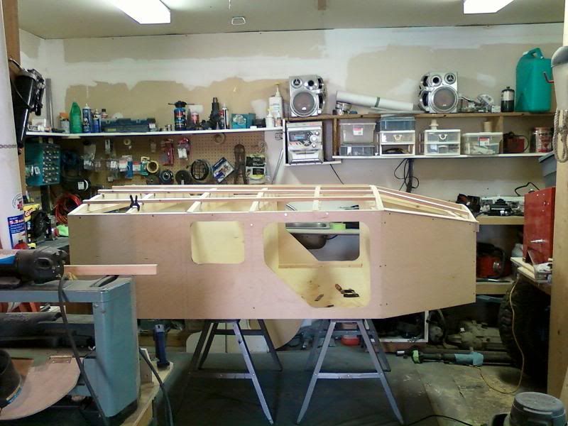

i have been lurking Expo sites for awhile getting ideas for my own, i am building my box structure from wood rather than the seems to be normal steel. I have good faith in the structure to hold up to the rigors of what ill use it for. Wood structure is significantly lighter that's for sure.
the build is underway, and will progress hopefully be done by spring.

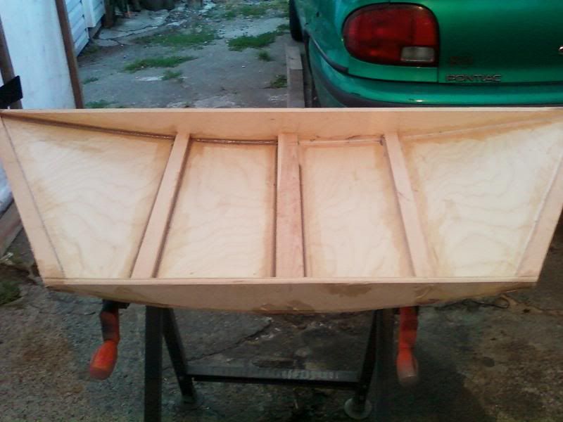

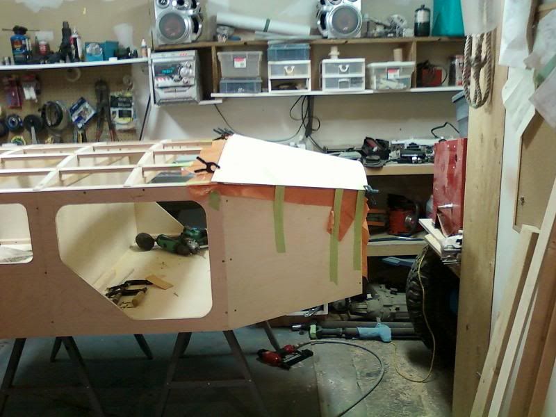

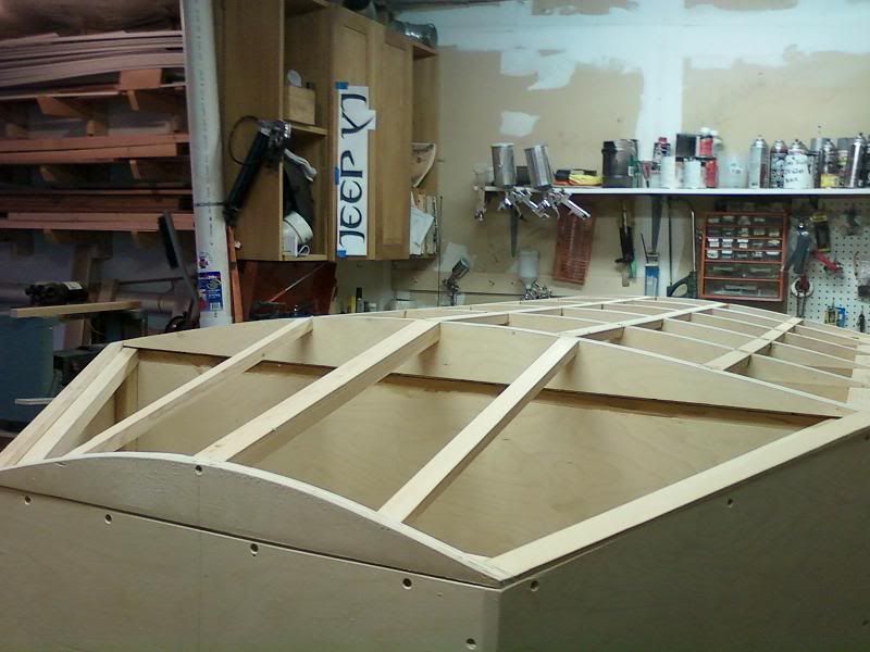

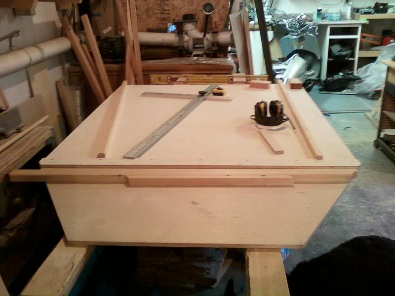

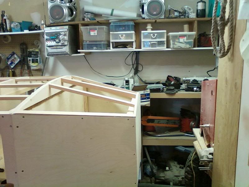

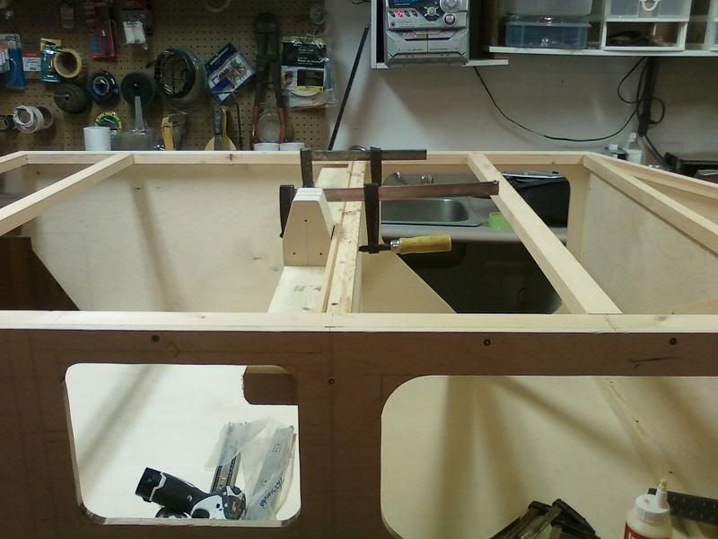

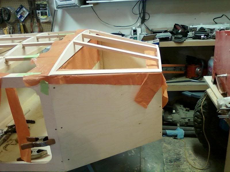

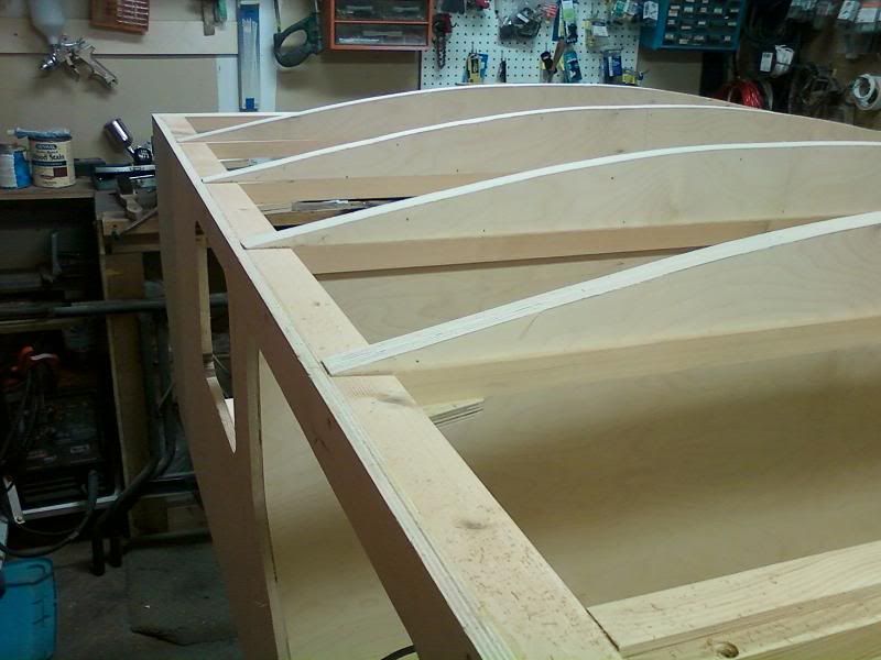

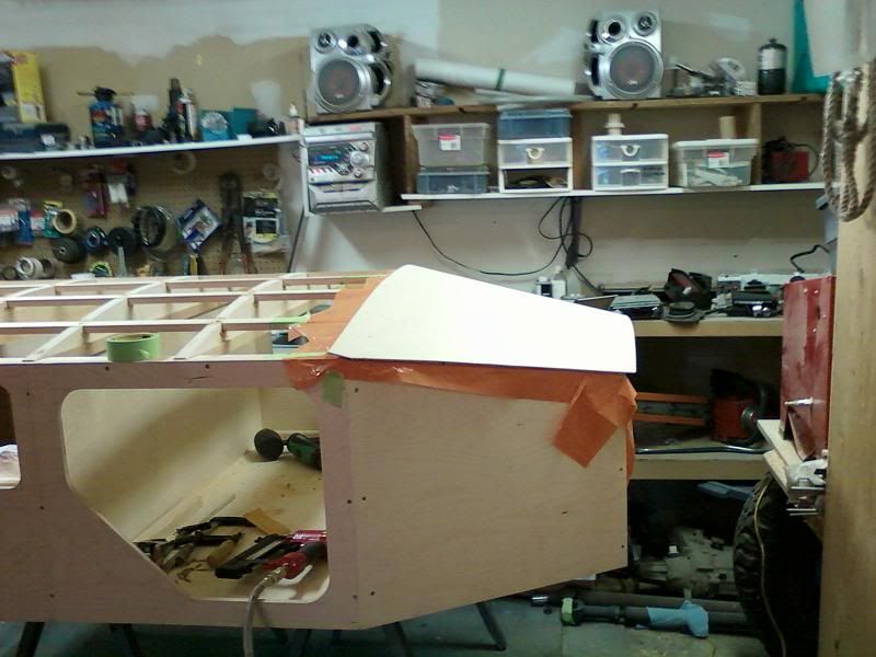

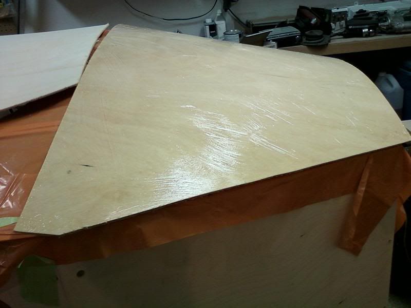

Any way got the top frames and ribs in and glued. worked on the nose box lid because the guys screwed up my water tank.

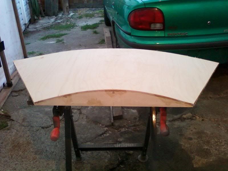

so got the nose box framing sanded and shaped to where i wanted prepped and glued on two skins 1/8" skins.
next i started the long process of filleting all the inside corners for glass tape. Got bored doing that and started work on back doors (no pics) will add later.

RandomAbstract
Just curious, what is the reason for the rounded top? It should shed water quite nicely and it looks great. However, you might roll out of your RTT. :eek:
Wavebreaker
No reason other than it looks way better than say a flat top. That and the challenge of getting it to look good. Plus this is a 1 off and i like to be different :)
The RTT will be supported by a small metal brace externally and a reinforcement plate internally. The other advantage to the curved top is a place to run wiring and plumbing that's up out of the way.I use conduit to run wires/plumbing.

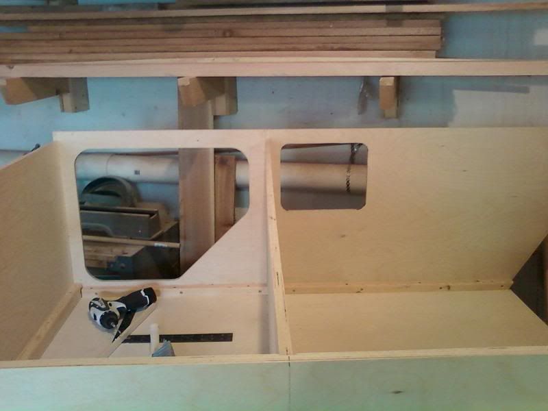

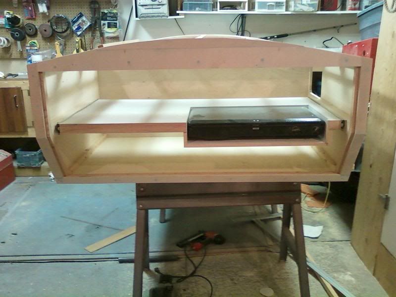

Update.
Trimmed and sanded front hatch turned out fine.

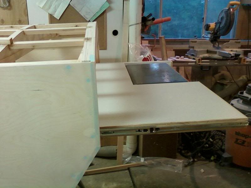

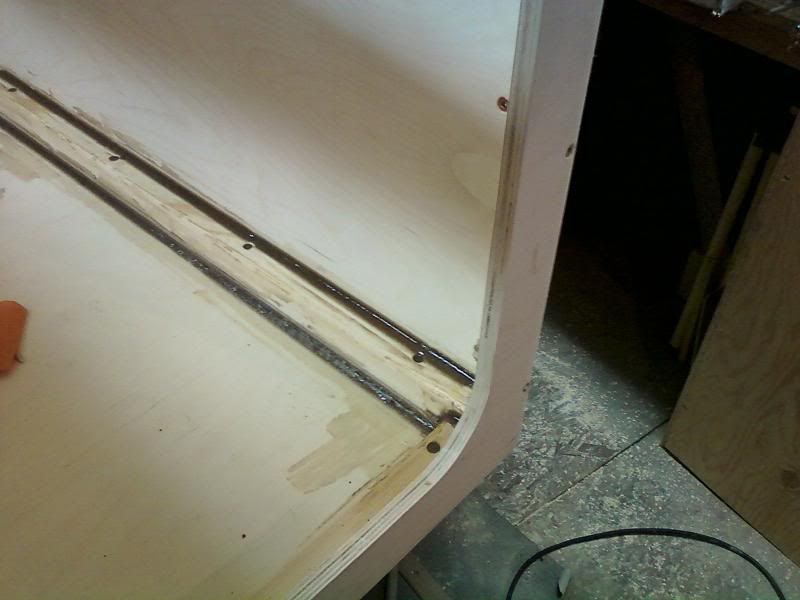

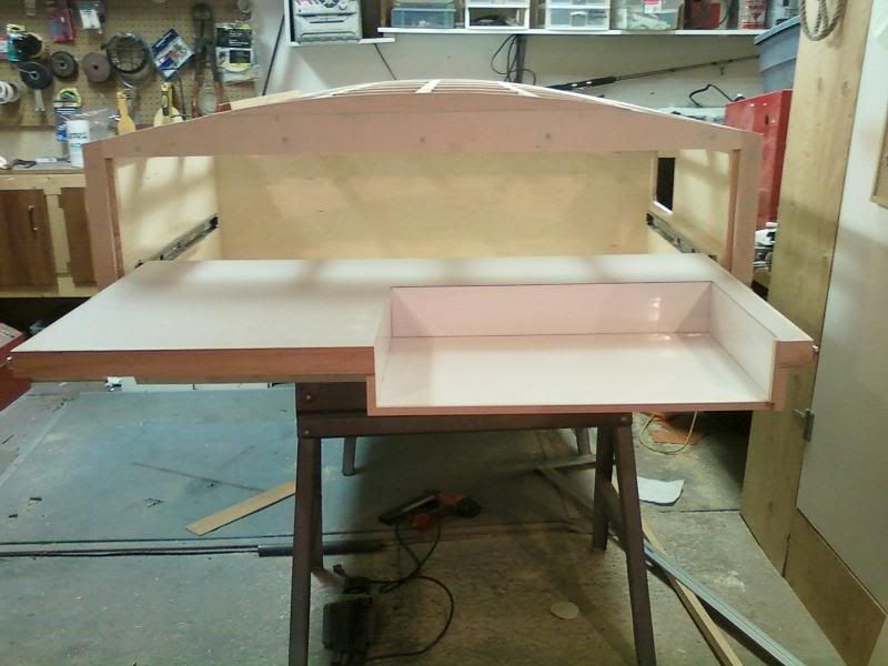

Started kitchen layout after trimming opening for doors.

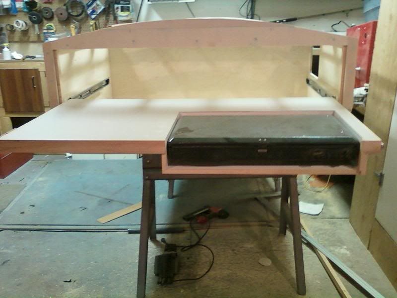

Built main counter ,laminated,trimmed and temp installed so i can measure for everything else.
