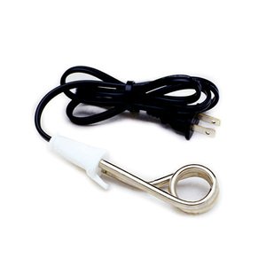

or what about a [URL="http://www.amazon.com/NORPRO-559-Immersion-Warming-Liquids/dp/B000I8VE68/ref=sr_1_cc_2?s=aps&ie=UTF8&qid=1327463650&sr=1-2-catcorr[/URL] connected to a $80 DC 12V 15000mAh Large capacity Ebay Battery? will it be hot enough and will it heat up a few gallons to shower temp within an hour ? http://www.ebay.com.au/itm/DC-12V-1...tteries_SM&hash=item231855e179#ht_4246wt_1396

the 12v heater pipe i posted above apparently will take hours for a few gallons tank to reach appropriate temp, i'm not that patient ^^
