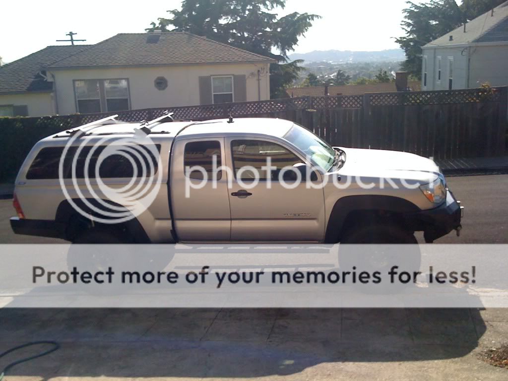

After 16 years, its time to replace my 06 TRD Off Road Tacoma. This wasn't planned but accidents happen & so here I am starting a new build. My 06 had custom skids, sliders, & bumpers, a high pinion Currie rear axle, lockers front and rear, and was re-geared to run 35" tires. Rear suspension was OME Dakar springs w/ add a leaf , shackle flip, 14" Bilstein's on custom hangers, & front suspension was Fox 2.5 coil overs, Total Chaos UCA and LCA. This is just to give you some idea of what I'm used to:
