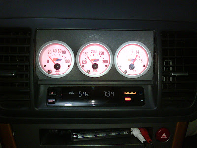

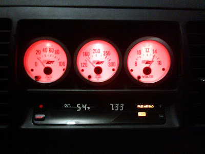

Finally got around to making a simple gauge pod for the cubby space in the dash of the Superu.
Previously I had a single din 3 gauge bracket in there with a filler piece to close up the gap. I had a spare half hour today so I found a donor DVD case, trimmed it to fit the space, cut out 3 holes and fitted it to the cubby.
The color of the plastic actually matches the dash better than the pics indicate.
Pics are from cell phone, so not the best but you can get the general idea.

Looking good. Oil pressure looks a little low even for idle. Running really thin oil?
Thanks. It's actually the result of a faulty sender unit. Been flaking out a bit lately. Replacement is on the way. :ylsmoke:
