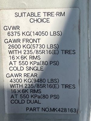

And like others have said, pay attention to heat build up. I have an inside the tire TPMS and watch for heat and pressure buildup especially in summer. When I'm full of diesel and water, I weigh in at just over 13,000#. Traveling too fast (65 mph+) on a highway when it's over 90 degrees could cause problems. Simply pay attention to your equipment. Big trucks are not sports cars. Take it easy, it's the voyage not the destination.
What load index do the Toyo M/T III have?
From Tire Rack.com in the US​
Selected Size​
  • Size: 37X13.5R17LT
  • Service Description: 131Q
  • Load Range: E
  • UTQG: None
  • Maximum Load: 4,300 lbs
  • Maximum Inflation Pressure: 65 psi
  • Tread Depth: 21/32"
  • Tire Weight: 91 lbs
  • Measured Rim Width:11"
  • Section Width:14.6"
  • Tread Width:10.8"
  • Overall Diameter: 37"
  • Revolution Per Mile: 560
  • Country of Origin: Japan
