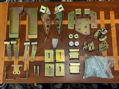

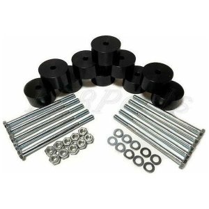

Here is an example. I was shopping for a 2" body lift for my Range Rover Classic and in the US and from a reputable Range Rover specialist vender their body lift kit consisted of a few "pucks" and longer bolts, cost $189.00. From Australia the kit included triangulated braces tying into the frame, seat belt anchor extensions, brackets to lift the front and rear bumpers, etc. Cost $821.00 US.
The difference in design is very evident.
