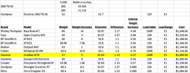

10/2/24 - 33's!
OK, after almost 50k on the Duratracs, I up-sized to 285/75/16 General Grabber ATX's. Several things went into the selection, not the least of which was weight. Per my research the bigger size Grabbers add about 5 pounds per tire, relative to the 265/75 Duratracs. I wanted to check out the Nokian NAT's, at only 1 pound heavier, but didn't see a lot of reviews, and they seem to be perpetually backordered in 285s.
I also wanted the 3 peak rating, and wanted them to be cool looking.
The new Duratrac RT's and BFG KO3's were quite heavy, as are the Falkens - and the price was good on the Generals as well.
Here's my research chart, in case anybody else is considering the same change.
So far they're great, but I only have about 50 miles on them, all highway. We'll see how they do this winter. Tight fit, but no rubbing with the "melt mod".
