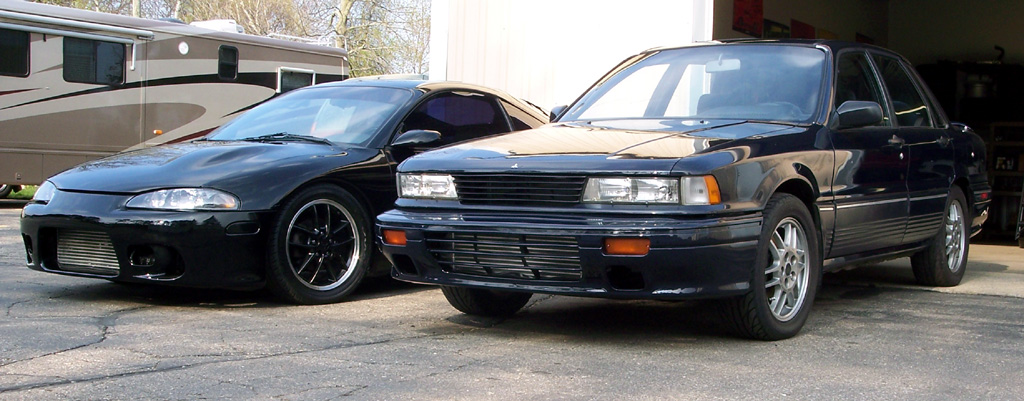

Here's a handful of other turbo 4G63 cars i've owned everything from daily drivers to 400hp summer cars;
I wont bore you with all the pictures, there's probably another 5 2G AWD dsm's and a ton of 1G AWD DSM's
