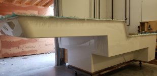

What is the thickness on the NL glass layup? Is it a woven matrix? I had to to tear into my Northern Lite light a little bit to repair some rot in the floor and a crack on the shell at the bottom of the door but it was over 15 years ago and I don't remember.

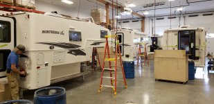

It s strand shotted from an air gun. There is a video on YouTube that show the build progress. First is gel coat apply to the mold, then strand fiberglass shoot from a gun while another guy roll it tight and compact. It s very thin…. As very little regidity and when it come out of the mold… it s very wimpy and flexi. Then become hard as the foam and other part of the camper are added. It s such a fun process to look at!
