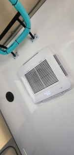

Over on FB on the OBI Dweller USA group there is a guy, David Faust, that is going to do a bunch of things to try and get the AC to work better. I’d follow him and see what he comes up with.
It sounds like it is going to take a number of mods, air return relocation, better insulation, etc, to get the AC to work better in our Dwellers.
Been there, done that. But I'll sit in my 68° Dweller in south Texas in July and scroll on my phone and watch the same progress I experienced. 😅

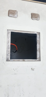

On Friday, 06/21/24 I will be placing an order for Air Conditioner adapters. I currently have one person that is grabbing one.
$350
What it does: deletes original over the bed skylight that acts as a furnace in the summer and creates a standard North American RV A/C opening.
What's included?
  • A/C adapter
  • Transfer Punch
  • Alignment bushings
  • Install assist tabs
  • Riv Nuts
  • Bolts/Washers
  • Instructions
What's not included?
  • Wiring
  • Labor
  • A/C unit
  • Common sense
  • Shipping
  • Tools
This will only fit 450mm x 400mm skylight models. If you have something other than this, DM me.
