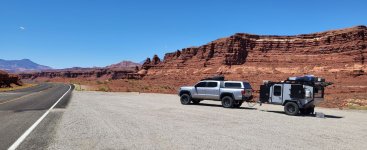

Exact heights are going to depend on your specific vehicle and on the type of coupler you're using on the trailer.
When you measure it out make sure to account for the inevitable sag caused by the tongue weight. The actual hitch on my Tacoma will drop 2 inches when the trailer weight is put on it. That means the ball needs to be 2 inches above level in order for the trailer to sit level. You have to start with your closest guess then load up the trailer and hook it up. Only then can you see where it will actually sit and adjust the hitch height accordingly.

Got any pics of the trailer on your Tacoma?
Here is the truck by itself with Icon RXT springs, set up in the heaviest configuration:
And here is the truck and trailer, with those springs, after a couple thousand miles pulling the trailer. You can see that it doesn't sit quite so proud anymore...The trailer is clearly a bit low on the tongue end. It started out level...
And here is the truck and trailer after a couple thousand miles with Deaver Expedition Stage III springs. Possibly not the best angle, but the rear of the truck clearly sits higher, and the trailer is now a bit high on the tongue end. Truck and trailer are loaded up the same amount in both picks.
