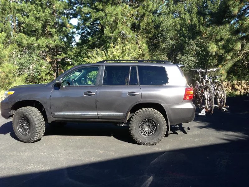

More pics
attachment.php
Some more pics. We supplied some Hutchinson RockMonster 17x8.5" double beadlock wheels in black. Running Goodyear MTR 285/75R17 tires. Removed the running boards. Next up, Sliders, bumpers, winch.
